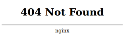

On page 1, Sam posted a link to hanggliding.org. The post at that link is now gone:
       http://www.hanggliding.org/viewtopic.php?p=281623

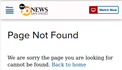

On page 2, Sam posted a link to a 10 News story. The news story at that link is now gone:
       http://www.10news.com/news/31054994/detail.html

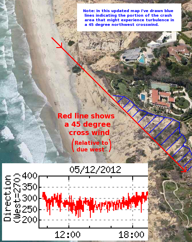

Bob Kuczewski wrote:
Posted: Fri May 18, 2012 20:32 UTC
Post subject: RE: Fatal Crash at Torrey Pines
Here's a picture that combines some of the US Hawks topic analysis into a single image.
The background image shows the general location around the incident. The red arrow shows a 315 degree wind direction (45 degrees to the normal westerly wind) drawn tangent to the point of land jutting westward north of the incident location. The wind history chart from that day (lower left insert) shows a mostly westerly (270 degree) wind with two spikes of about 315 degrees just after noon (around the reported time of the incident). Those two spikes would tend to produce a 45 degree crosswind as shown by the large red line.
The blue shaded areas (blue lines) show a portion of the normally flyable ridge that might be experiencing mechanical turbulence from the point of land and palm trees to the northwest of those shaded areas. From the reports I've seen, this is where the downed pilot was found.
None of this is conclusive evidence of what might have happened, but it is important for all pilots to remember how fast wind directions can change and to be aware of how those changes may interact with the local terrain.
It's always sad to lose a pilot. It's even sadder to not learn anything from that loss.
Fly safe.

With regard to this incident, I currently believe that the two spikes in the diagrams were the major contributing factor. There may be other issues related to the Torrey concession (like what kind of training she got, whether that wing was sold to her above her abilities, etc), but I don't anticipate that there will be any "smoking gun" implicating the concession in any serious wrongdoing.
However, that's just in THIS case. There have been other cases where it's very very clear that we need to have an independent body to review those incidents. For example, there was a relatively recent incident where two students collided - both presumably on the radio with the concession's instructors. I've never seen an investigation of that incident, and I am not aware of any action taken. The incident that I mentioned above (where Brad Geary was flying an unrated PG student - his brother - who crashed into the hang glider setup area) was another example where an independent review was desperately needed.
