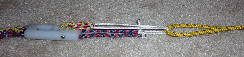

Re: missing release
Postby TadEareckson » Thu May 05, 2011 6:18 am
We ALMOST ALWAYS have enough margin and/or redundancy in these situations to come out smelling like roses and thus the hang gliding community considers them no BFDs, occupational hazards, costs of doing business. Then we continue right along as we always have until someone gets killed a year or two later, blame the pilot who just froze, made no effort to release, shouldn't have been flying in those conditions at his skill level, and take a flight in his honor on the same equipment.
There's stuff I can't see and don't know about this configuration and tow but we do have several good, proven, time honored ways to kill ourselves here.
It was a super tow to cloud base ~2500'.
I'm guessing payout winch? Hopefully platform launch since this isn't a two stage release.
As the tow vehicle neared the end of the runway...
Still maintaining full tow tension / pressure gauge reading or slowed down / backed off? I'm guessing the former.
I glanced down to visually locate the release pin line.
Is that a luxury your gonna be able to afford when the shitt's hitting the fan down low?
Maybe two seconds later...
That can be a very very long time when the shitt's hitting the fan down low. That can be the rest of your life.
I felt a normal thump of release...
Suggesting that you WERE still under normal climb tension.
...and the tow line fell away.
So you didn't hafta spend the next forty-three seconds hacking away with your hook knife the way Todd did at similar altitude a bit over a year ago.
http://www.hanggliding.org/viewtopic.php?t=16384
WTF ? Mind controlled release ?
No, weak link failure.
Here's what was left attached when I landed...
Was the (three-string?) release recovered from the end of the towline?
Not relevant to this situation but... The bridle appears to be Perlon. Bad idea. You want low stretch (Dacron, Spectra) and short - going to tow loops versus carabiner.
Where's the lanyard anchored?
The lanyard's only going to one side. Why not run lanyards to both?
What would be the downside to having a pair of barrel releases at your hips?
If you had used a Koch one stage (or two stage used as a one stage) would you have been able to actuate it a little faster, without having to look for a trigger?
At what tension did you launch and how much tension were you feeling at the top?
How much line was out?
What was the weak link strength and why?
What was your glider model and size and your flying weight?
Can you imagine being in a situation in which things could get really really ugly if that weak link blew at the tension you were feeling when it did?
You're using:
- an actuator that you've gotta look for;
- an actuator that, at altitude with the glider level and trim and everything normal and on schedule, you are unable to trigger after the second hand has ticked a couple of times;
- an actuator that requires you to take a hand off to blow while you pretend to be able to fly the glider with the other - possibly while fighting a lockout;
- a weak link that blows under normal tension.
People have died for all of those reasons individually. You've got them all stacked together. Gonna do anything differently next time or the same - 'cause this is the way everybody's always done it - and expect different results?

It's a bent pin that was straightened release...
Yeah, thought they looked a bit suspicious. Seems like it would make more sense to start out with straight pins but I guess the thinking is that they'd be pretty easy to bend back to the original shape to use for Bailey releases.
I thought this would topic would spark your interest.
Always. Too bad hang gliding has never managed to evolve to the point at which it's way less interesting and way more fun.
No the release was not connected to the tow line.
Yeah, at one point in my thinking I knew that but the light went back out while I was crunching the concept of putting a weak link downwind of the release.
...after the weak link performed as designed...
So what's that weak link "designed" to do? Yeah, I know, blow - but at what point and to accomplish what?
Ignoring the strength of the weak link and the actuation system for the moment... That's a safe but stupid design. You shouldn't hafta lose your release (as well as your tow) every time you blow a weak link (which should be never anyway).
For a three-string I kinda like what Zack's crowd is doing. Make the loop that engages the tow ring the weak link.
Have you heard of "topping off the tow"?
Yeah, even done it a few times - which is why I'm at a loss to understand how a weak link could possibly blow while one was at the point of completion and working on separating voluntarily.

You didn't have a "release malfunction" - in the sense that it did exactly what it was designed to and you were instantly / cleanly / completely separated from tow... But:
1. I've never before heard of a configuration that automatically costs you one release mechanism per weak link failure - in hang gliding, paragliding, or sailplaning.
2. I'd have thunk that the reason you had decided to release at that point was 'cause that you were no longer climbing and that the reason you were no longer climbing was 'cause the tension had dropped to the point of uselessness.
3. Despite all the total rot taught by the morons running the flight parks and published in works of fantasy like Skyting and Towing Aloft, a weak link has one function and one function only - to blow before the glider does in a really rare and extremely ugly situation in which the people have almost certainly totally lost control of the tow a long time ago. Weak links which fail in routine circumstances are expensive and dangerous.
I'll ping Zack and let him know about this discussion.

Need a number. From your photos my best guess is that the weak link is 5/64 inch / 205 pound Dacron leechline. That's gonna blow at about two hundred pounds - which would be pathetic - and does seem consistent with what you reported feeling.
Zack's crowd is using a loop of 205 Lark's Headed onto the tow ring loop of a three string release. It thus becomes an extension of the tow ring loop so you just ignore it and connect your three string normally. I'll attach his photo.
Zack claims it blows around six hundred pounds and - although I haven't tested it myself - that sounds about right. And that's a pretty good one-size-fits-all number.
I would advise that you connect your remaining release directly to the bridle and duplicate Zack's configuration.

P.S. I'm not seeing a way to get the photo up - may be a problem with my antique browser. But Bob can probably stick it in later if I send it to him. And anyway, the topic IS "missing release".
Admin Note: Here's the "missing release" that Tad sent to me by email:

It looks like you guys are swapping information...
Swapping?
So far all I'M getting is a picture of glider end towing equipment which has evolved significantly backwards from what I was using twenty years ago.
So far all I'm doing is spending a lot of time and effort GIVING much better information than the "pros" controlling this sport are SELLING.
This I am perfectly happy to do. But I'd be a lot happier KNOWING that this information is getting through and causing things to move forward and, so far, I'm not getting an indication that that's happening.

Thanks, but the problem is my 2003 Mozilla 1.3.1 browser.
At the bottom of your posting page, there's a tabbed box that looks like this...
At the bottom of YOUR posting page - but, I'm afraid, not mine.
I don't see those tabs - just empty white space.
If I Select All, Copy, and Paste into word processing I DO get text that reads "Options" and "Upload attachment" but there's nothing visible or clickable on the browser page. If I click in the location where "Upload attachment" should be, nothing happens. I was pretty sure I'd have been OK firing up the other computer but I didn't feel like firing up the other computer just then.
I get this issue with a lot of stuff on the Hawks and Strings pages and often have a few hoops to jump through to get things done.
Thanks for the fishing lesson anyway, I'll send you the photo - just 71 K.
P.S. The tabs are visible/functional for me back on the main drag - just not here in South West Texas.

What was the material? How many strands/loops?
You can see it in the photos in the first post. Comparing the line diameter to the pin width my best guess is 205 leechline (single loop).
