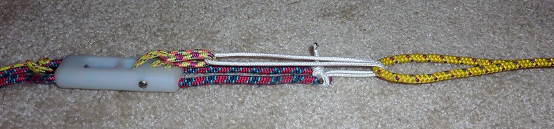

Re: missing release
PostPosted: Thu May 05, 2011 6:18 am
by TadEareckson
We ALMOST ALWAYS have enough margin and/or redundancy in these situations to come out smelling like roses and thus the hang gliding community considers them no BFDs, occupational hazards, costs of doing business. Then we continue right along as we always have until someone gets killed a year or two later, blame the pilot who just froze, made no effort to release, shouldn't have been flying in those conditions at his skill level, and take a flight in his honor on the same equipment.
There's stuff I can't see and don't know about this configuration and tow but we do have several good, proven, time honored ways to kill ourselves here.
It was a super tow to cloud base ~2500'.
I'm guessing payout winch? Hopefully platform launch since this isn't a two stage release.
As the tow vehicle neared the end of the runway...
Still maintaining full tow tension / pressure gauge reading or slowed down / backed off? I'm guessing the former.
I glanced down to visually locate the release pin line.
Is that a luxury your gonna be able to afford when the shitt's hitting the fan down low?
Maybe two seconds later...
That can be a very very long time when the shitt's hitting the fan down low. That can be the rest of your life.
I felt a normal thump of release...
Suggesting that you WERE still under normal climb tension.
...and the tow line fell away.
So you didn't hafta spend the next forty-three seconds hacking away with your hook knife the way Todd did at similar altitude a bit over a year ago.
http://www.hanggliding.org/viewtopic.php?t=16384
WTF ? Mind controlled release ?
No, weak link failure.
Here's what was left attached when I landed...
Was the (three-string?) release recovered from the end of the towline?
Not relevant to this situation but... The bridle appears to be Perlon. Bad idea. You want low stretch (Dacron, Spectra) and short - going to tow loops versus carabiner.
Where's the lanyard anchored?
The lanyard's only going to one side. Why not run lanyards to both?
What would be the downside to having a pair of barrel releases at your hips?
If you had used a Koch one stage (or two stage used as a one stage) would you have been able to actuate it a little faster, without having to look for a trigger?
At what tension did you launch and how much tension were you feeling at the top?
How much line was out?
What was the weak link strength and why?
What was your glider model and size and your flying weight?
Can you imagine being in a situation in which things could get really really ugly if that weak link blew at the tension you were feeling when it did?
You're using:
- an actuator that you've gotta look for;
- an actuator that, at altitude with the glider level and trim and everything normal and on schedule, you are unable to trigger after the second hand has ticked a couple of times;
- an actuator that requires you to take a hand off to blow while you pretend to be able to fly the glider with the other - possibly while fighting a lockout;
- a weak link that blows under normal tension.
People have died for all of those reasons individually. You've got them all stacked together. Gonna do anything differently next time or the same - 'cause this is the way everybody's always done it - and expect different results?

It's a bent pin that was straightened release...
Yeah, thought they looked a bit suspicious. Seems like it would make more sense to start out with straight pins but I guess the thinking is that they'd be pretty easy to bend back to the original shape to use for Bailey releases.
I thought this would topic would spark your interest.
Always. Too bad hang gliding has never managed to evolve to the point at which it's way less interesting and way more fun.
No the release was not connected to the tow line.
Yeah, at one point in my thinking I knew that but the light went back out while I was crunching the concept of putting a weak link downwind of the release.
...after the weak link performed as designed...
So what's that weak link "designed" to do? Yeah, I know, blow - but at what point and to accomplish what?
Ignoring the strength of the weak link and the actuation system for the moment... That's a safe but stupid design. You shouldn't hafta lose your release (as well as your tow) every time you blow a weak link (which should be never anyway).
For a three-string I kinda like what Zack's crowd is doing. Make the loop that engages the tow ring the weak link.
Have you heard of "topping off the tow"?
Yeah, even done it a few times - which is why I'm at a loss to understand how a weak link could possibly blow while one was at the point of completion and working on separating voluntarily.

I don't have a whole lot of truck tows and the highest I ever got was only a bit over fifteen hundred feet.
Yeah, I was surprised at the tension Zack guessed he was feeling near the top of tows. Granted, he's probably often lifting a lot more line than I did but I woulda thunk the drivers would be pretty good at backing off on the brake pressure to compensate a bit.
But, what the hell, it's not a safety issue and probably doesn't make any appreciable difference in the efficiency of the tow.
You didn't have a "release malfunction" - in the sense that it did exactly what it was designed to and you were instantly / cleanly / completely separated from tow... But:
1. I've never before heard of a configuration that automatically costs you one release mechanism per weak link failure - in hang gliding, paragliding, or sailplaning.
2. I'd have thunk that the reason you had decided to release at that point was 'cause that you were no longer climbing and that the reason you were no longer climbing was 'cause the tension had dropped to the point of uselessness.
3. Despite all the total rot taught by the morons running the flight parks and published in works of fantasy like Skyting and Towing Aloft, a weak link has one function and one function only - to blow before the glider does in a really rare and extremely ugly situation in which the people have almost certainly totally lost control of the tow a long time ago. Weak links which fail in routine circumstances are expensive and dangerous.
I'll ping Zack and let him know about this discussion.
With a good winch we might get 1000' max.
1. So either that was a super tow not at your local airfield or a super tow to over a fifteen hundred feet shy of cloudbase followed by a climb to cloudbase.
2. I know that aerotowing is expensive and a royal pain with all the tug driver regulations nowadays but it sure is nice being able to go as high as and wherever you want (and not having to deal with all the rewind issues).
3. Stu Caruk (http://www.towmeup.com) is probably a real good place to start for a winch. Ain't cheap but my guess is that the more you pay at the beginning the less you're gonna pay down a rather short road.
4. And there's no doubt whatsoever that people have died 'cause people were towing static instead of using a payout winch.
There's some about tow forces I do not understand, at least unable to discuss in correct terminology.
That's key. I overshot a field on my third mountain flight 'cause my idiot "instructor" didn't know the meaning of the word "turnpoint".
The force that took my release did not feel excessive. It did not even feel unsafe.
A weak link blow is SUPPOSED TO BE like a parachute deployment.
1. It should never happen in the course of an average pilot's flying career.
2. With rare exceptions, it should only happen after a pilot has screwed a couple of pooches bigtime.
3. The pilot should be scared shitless just before it happens.
4. The pilot should not expect to live if it happens down low.
Need a number. From your photos my best guess is that the weak link is 5/64 inch / 205 pound Dacron leechline. That's gonna blow at about two hundred pounds - which would be pathetic - and does seem consistent with what you reported feeling.
Zack's crowd is using a loop of 205 Lark's Headed onto the tow ring loop of a three string release. It thus becomes an extension of the tow ring loop so you just ignore it and connect your three string normally. I'll attach his photo.
Zack claims it blows around six hundred pounds and - although I haven't tested it myself - that sounds about right. And that's a pretty good one-size-fits-all number.
I would advise that you connect your remaining release directly to the bridle and duplicate Zack's configuration.
And if you have other ideas for weak links I'll be more than happy to load test them for you if you don't have a test rig.
Something I'd like to know more about as a PL pilot.
Platform, reel-in, foot, static, aero... The weak link has only one function and it only cares about the strength of the glider, not the flavor of the tow. And thus you use the same weak link for your glider, regardless of the flavor of the tow (despite as the crap you/we've been fed).
It might be a safety issue without a weak link.
1. Nobody with half a brain or better advises towing ANYTHING without a weak link. But there's a tradition in hang and para gliding that Donnell seems to have founded that you either use a weak link of one G or less - preferably WAY less - or nothing at all. Nobody ever died from using a two G weak link and a two G weak link is never gonna blow in the real world.

Admin Note: Here's the "missing release" that Tad sent to me by email:
Re: missing release

Re: missing release
PostPosted: Thu May 12, 2011 6:00 am
by TadEareckson
What was the material? How many strands/loops?
You can see it in the photos in the first post. Comparing the line diameter to the pin width my best guess is 205 leechline (single loop).
