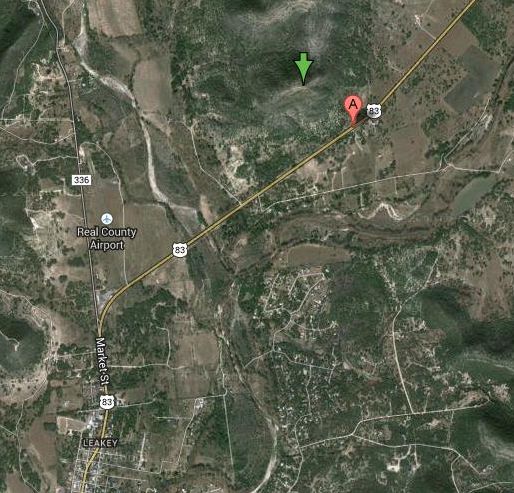

If you are on google earth, the FL at Leakey is here: 29.7554*N - 99.744*W

SamKellner wrote:... the FL at Leakey is here: 29.7554*N - 99.744*W
That looks pretty good Sam!! It looks like there's a pretty nice bowl there just northeast of launch which might work on a variety of wind directions!!
Super job on working within your community to open sites Sam!! If people did this everywhere, we'd have a lot more flying opportunities around the country.
Hooray Sam!!!    :clap: :clap: :clap: :clap: :clap: :clap: :clap: :clap: :clap: :clap:

Launch then go fly
Postby SamKellner » Sun Nov 17, 2013 5:14 pm
That's it. :thumbup: The small bowl West of the pointer works best in S. and SSE launch winds. If its SE to ESE breezes, the more East facing ridge works and is larger.
Strategy for flying at this site is different than most. It's strong point is not a ridge soaring site. Anyone can see that with 3 or 4 gliders in the air in marginal to fair conditions, it will get crowded fast.
The object here is to get in the air and ridge soar till a smooth Texas thermal takes you to cloudbase, which usually doesn't take long if you're watching the Cu. development. Once you're at cloudbase the entire range works since the launch is centrally positioned on a point, between the East Frio canyon on one side and the West Frio canyon on the other. When the Cu clouds street up to the North it's good XC potential. Plans are to set some FL records this summer.
And for new pilots who are ready for their first hill launches, the bailout LZ is easily within the glide of a single surface wing.
Thanks for putting up the aerial view, Bob. :thumbup:
