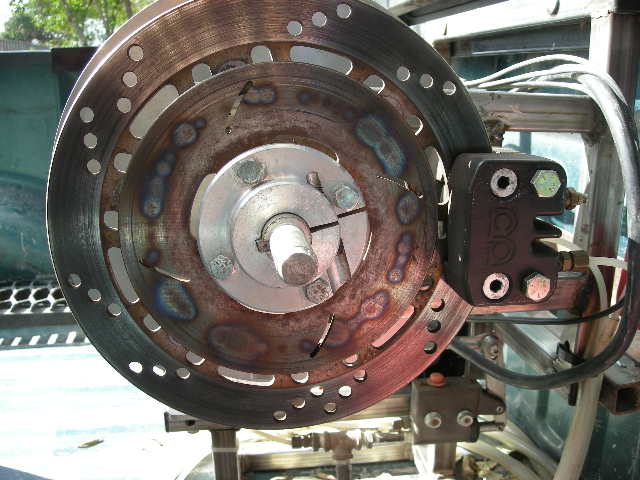

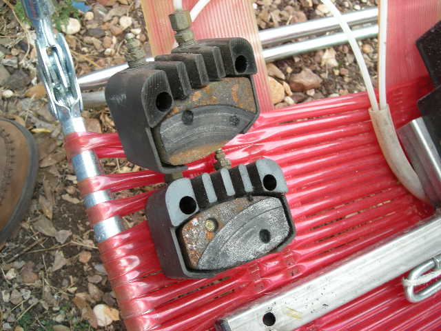

We towed today.. Somewhat better results, but nowhere near what it should be.
An inspection of the brake calipers reveals that the designed alignment of the caliper assy is not good.
You can see by the wear pattern that ~40% of the pads were not even contacting the disc! :wtf:

Even with adding the extra line to increase the spool diameter and even with repositioning the caliper so they contact the disc ~100%, this winch is still living up to it's name,
"Mini Mojo's". All our launches have been very predictable and smooth. Climbs great initially but then brake fade sets in.
If we continue to refine this payout winch, a larger diameter disc with more ventilation slots might give us the desired performance.
Another solution: Two of our members have purchased a proven modle and it should arrive any day. :!: TBT, I think is the name.
So the trials will continue. We sure hope to have the bugs worked out by spring.

I did get the 10" disc installed on our WIP, ATOL wanna be winch.
The caliper re-mount will be easy, <1 welding rod.
Then we'll see?

Well, I got the larger disc mounted and the caliper re-mount completed. Haven't been out yet, but surely it will improve the performance.
