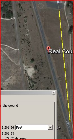

Postby Bill Cummings » Tue Jan 06, 2015 11:37 pm
Looks like 2,286 feet from take off to the pulley.
The grid direction is 174 degrees. About 14 degrees off of magnetic north.
Real Co. Airport.JPG (30.96 KiB) Viewed 17752 times

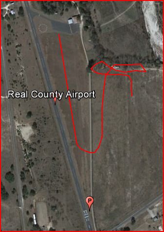

Postby Bob Kuczewski » Wed Jan 07, 2015 1:59 am
This is a rough idea of what we could do ...
I haven't done any checking on the scale, so let me know if you think the pattern is too large or small. I could also add a little hang glider or use one color for tow and another for glide.

Postby SamKellner » Wed Jan 07, 2015 5:43 am
Thanks for all the help Guys,
Bob, That pattern is too large by about 33%.
Can you reduce the width and length?

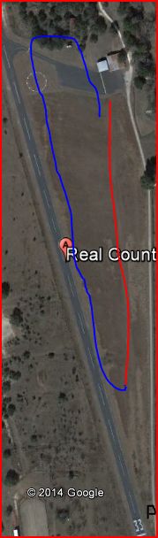

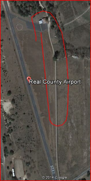

Postby Bill Cummings » Wed Jan 07, 2015 12:48 pm
Pattern right.JPG (28.57 KiB) Viewed 17746 times
pattern left.JPG (32.21 KiB) Viewed 17746 times

Postby SamKellner » Wed Jan 07, 2015 4:32 pm
Bill,
That looks about right for size. As I recall, Dave was having them turn the other direction after release. That would be a Left approach, right?
Also doing payout towing, if feels easier/safer to turn left for the down wind leg. Sorta follow the airport rd. Keep your speed up when approaching the tree line corner. G-12 on the grid.
Did you see that "ultralight adjacent to runway" remark on the 49R site you copied? 8-) 8-)

Postby Bill Cummings » Wed Jan 07, 2015 8:31 pm
I was thinking that to release and turn left would be turning toward a descending GA aircraft on its downwind leg of the DBF.
Greater distance is why I was turning right for HG & PG.
Bob’s pattern would have the base leg of the HG & PG crossing the runway low and possibly in the way of GA air traffic on final for the 15.
The pattern I chose would keep tow operations inside the left DBF for GA.
The closest conflict would be if GA taking off down the 15 and turning left before passing the 33 Displaced runway would have a releasing HG & PG just about to release in close proximity of the departing GA that might turn left too soon.
My pattern would not cross GA DBF or the runway.
Some tow operations at airports usually have each, GA & tow, turning opposite directions to avoid conflict. The problem with 49R is that your operation can’t be on the west side of the runway. If it were on the west side GA and tow turning opposite directions would give the most clearance.
I can see the benefit of turning left after take off. It stays away from the runway.
Possibly releasing and turning left will yield enough clearance with GA on the downwind leg of DBF.
It seems crowded when laying in bed in the dark and thinking about it.
(It makes my feet sweat and keeps me awake.)
I’ll have to check for the ultralight note.
