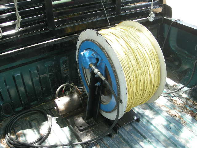

Eventhough we enlarged the rotor and re-mounted the caliper for full contact, the brake fade remained.
Terry and I purchased a spring scale, 0to200lb. We tied the scale to a tree limb and then to the tow line. Terry watched the scale. I drove.
First I drove 20mph for 1000ft and the scale remained at a constant 80lb. Our hopes were high, at least.
But as soon as I accelerated to cruise, ~30mph, the scales fell to ~20lb. :thumbdown: :x :problem:
Because the pads are too small, they heat up too much and the fluid does also. This causes it to slip.
We could try synthetic fluid that has a higher boiling point, but it would still be doubtful and might not preform much better.
We also purchased an auto brake rotor and calipers with the idea of r-n-r. To mount this new rotor/caliper it's gonna require a machine shop precision and take time.
It's a WIP.

As someone without much experience in towing, I'm surprised that your previous brake system wasn't up to the task. What kind of a vehicle was that disc from originally? If it can't hold pressure on a 250 lb hang glider for very long, it makes me worry about how long it can hold back a much heavier car down a long grade!!
That also makes me wonder if you can find specifications for braking systems that might help you pick one without so much trial and error. If so, that might be helpful for other people building similar systems.

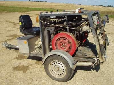

Steel line is ok and better than it sounds. At 2mm it has low drag but it is quite heavy. The worst attribute is its stiffness and the way it can bunch up.
But as I said it is relatively cheap and goes 2 or 3 seasons.
We always use chutes and can reel in before the line hits the ground.
I fly from the UK flatlands.
Regards Mike
