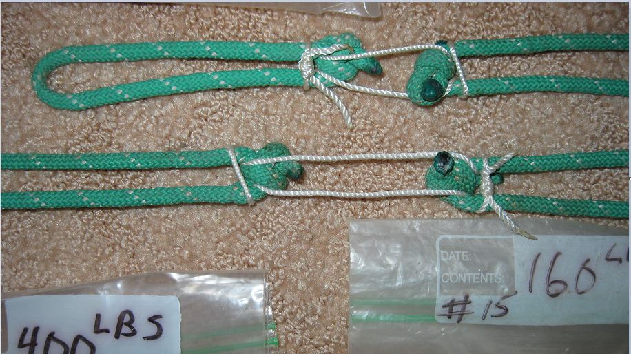

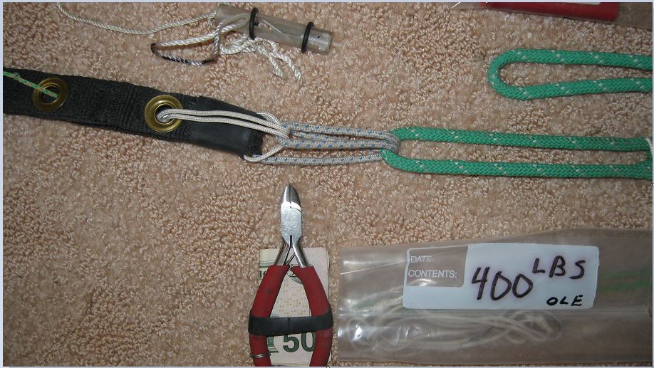

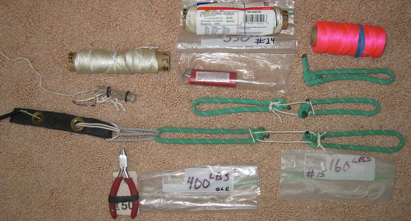

Here are some home made weaklinks from hardware store bought Mason line.
Once I ran out of the supper malifagorius (New word) tow dealer purchased expensive weaklink material and the stuff I needed was on back order.
I decided to go with the hardware store stuff that was always on hand all over town.
The way I went was with stuff I tested and rigged so that I could hook it to any towline anywhere and have my stuff always yield the same results.
That is the reason for the two green 1/4" loops on each side of the white weaklink for platform/payout or static tow.
My home made, two string, release has one string of smaller diameter cord than the first/longest larger diameter cord.
The longest largest diameter release cord hooks to the even larger green 1/4'' loop of the weaklink (three loop) assembly.
For stationary hydraulic winch pulley tow I use 70 to 130 lb weaklinks.
For static tow, car/truck/ATV/snow-machine, I use 222 lb weaklinks.
For payout winch/reels with too much line on them I never go above 350 lbs for a weaklink.
In the picture you can see a bag of 400 lbs for weaklinks. Those are for big pilots like John Ole Olson.
All loops of the three loop weaklink assembly can be tied in advance and just slipped over each other to make a connection.
This will eliminate the need to tie anything in the tow area. Tying is slow. Looping is fast even with gloves on.
I cut the line with a lighter and that keeps the ends from unraveling.
The wire cutters are only along to cut flying wires on unsafe gliders.
The 50 dollar bill is to hand to the glider's owner to mitigate the damage done to the flying wires.
The weapon (not pictured) is for protection if needed.
