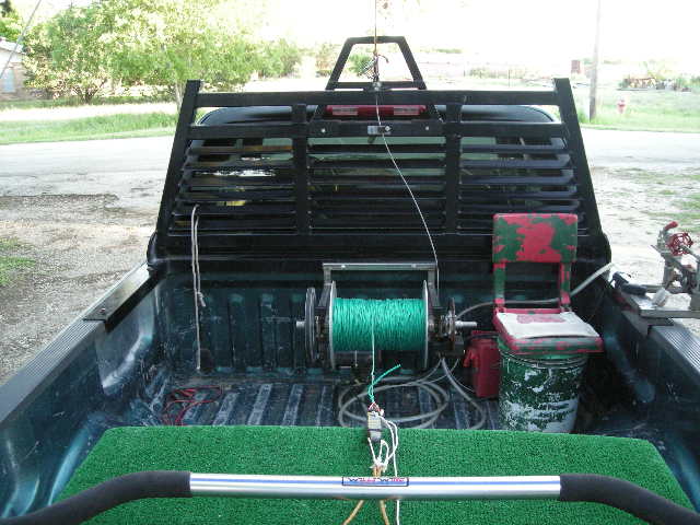

Fellow Hawks,
We added 2,000ft of spectra to the spool yesterday. Creating a larger diameter reduced the payout rpm and also reduced brake fade problem we have been experiencing with this winch. It's from Mojo's gear. Not an ATOL.
Today the climb rate while on tow was much better than before. The wind was ~45* cross so we only did one test flight, but obviously better results.

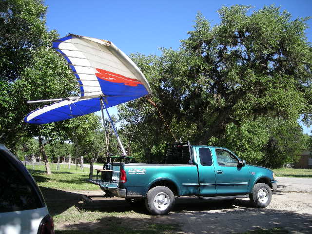

Some of the pioneers in platform towing call it "truck jumpin' ".

Great photos Sam!!!
Do you have any video of people launching with it?

Postby SamKellner » Sun Oct 03, 2010 8:07 pm
Naw, no video yet. If we had more members we might have a videographer.
All our launches have been very smooth, nothin' sudden.
Will try to get some video next time we're out.
I designed and built all the sub assys.

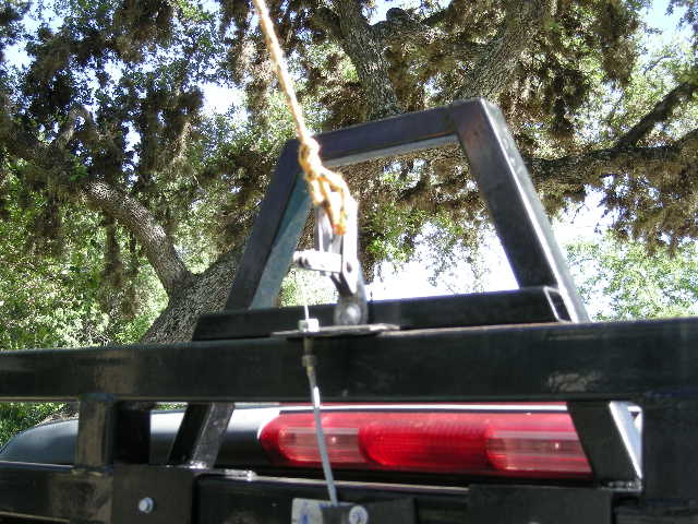

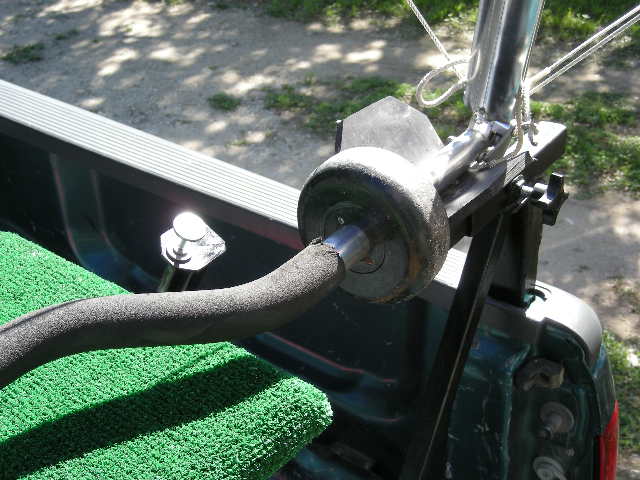

The nose release is a Switzer, operated with a choke cable pull knob, mounted on an adjustable arm. It works great, without having to remove your hand from the basebar.
Re: SWTHG club winch
Postby SamKellner » Sun Oct 03, 2010 8:14 pm
Here's the nose release
