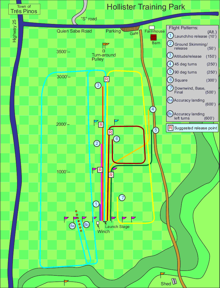

http://willswing.com/pdf/manuals/Scoote ... attern.pdf
I found this on WillsWing.com
There is a lot of good info here. :thumbup:
Can someone help me put the patterns on 49R :?: :roll: I could make some copies.
The layout is similar here except we have a runway on the right side. Our max useable distance is more like 3,000ft. than the 3,500 in the Hollister example.
With the ~500' difference to the pulley, how much will that change the altitudes and release positions?

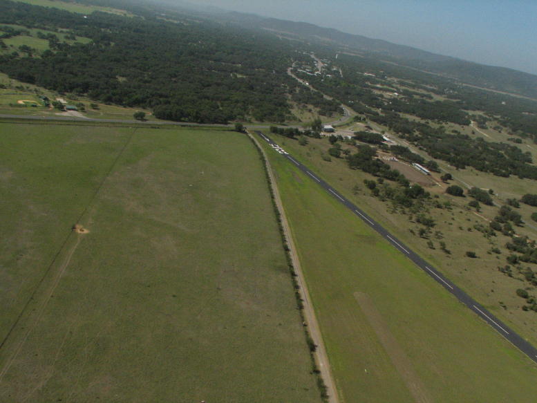

turnaround pulley location

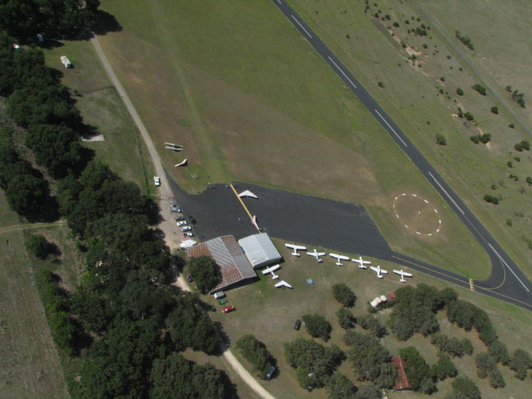

49R hangars

Here's the layout from that PDF:

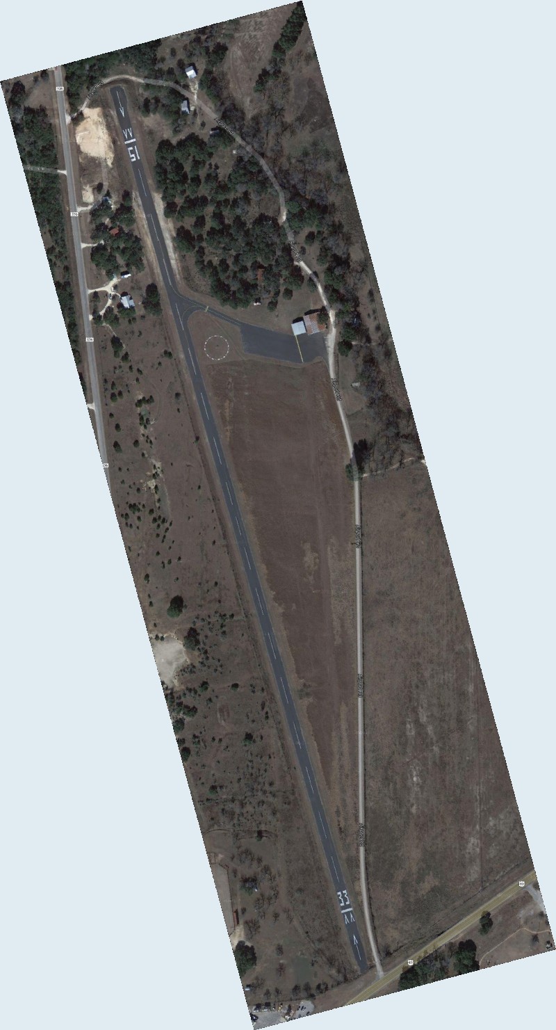

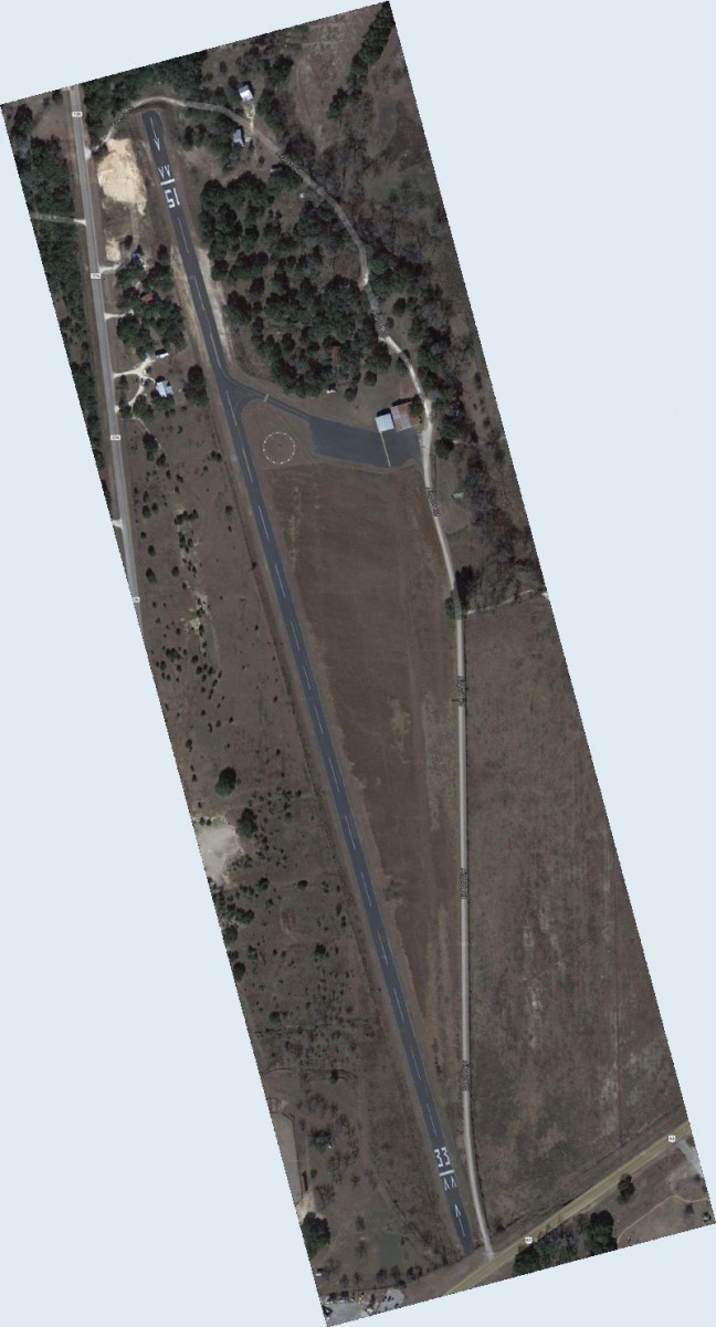

Here's a view of the airport. Where would you conduct your flight operations?

Postby SamKellner » Tue Jan 06, 2015 5:41 am
Thanks Bob,
Yes the airport is 49R. The scooter and glider launch position is at the south edge of the tarmac, in front of the hangars. Sometimes over toward the segmented circle, depending on breeze direction.
Most often the wind direction is straight down the rwy.
The pulley is down near rwy 33, south end. I think that distance is ~3,000ft.
The turf strip/rwy is directly in front of our 52'x52' hangar. That heading is a few degrees more north and south.
The entry road, Jim Scott Rd., is off hwy83, near threshold rwy 33, south end.

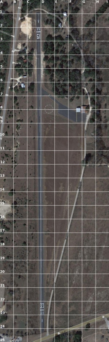

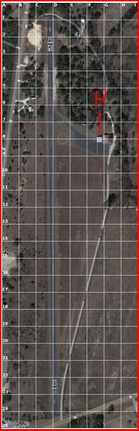

To help with the discussions, here's a picture with a grid.
With that notation, I think the hangar would be at G8. The segmented circle is halfway between D8 and E8.
Can you give me the other key locations using similar notation?

Postby Bill Cummings » Tue Jan 06, 2015 3:27 pm
I thought Sam’s hanger is the brighter roof to the left of the cross hatch marked G8.
I would prefer to refer to the squares like on a map Range and Township areas.
I would guess described my way (or the hwy way buddy) would be the brighter colored hanger roof is in the SE corner of area (square) F8 and the NE corner of area (square) F9
The segmented circle described in map lingo might be the southern half of area (square) D8 and the northern half of area (square D9.
This assumes that a person standing on the numbers “15” (150 degrees) looking down the length of the runway is looking SSE (magnetic). What is the mag. Declination at 49R? What are the grid degrees. I’m too lazy to check google earth.

Postby SamKellner » Tue Jan 06, 2015 6:16 pm
Thanks Bill for the story. I do have 'Towing Aloft".
The Southwest Texas Hawks :) hangar is F-8 and F9. 52'x52', yes the one with the newer roof.
The scooter is set up in E-9 or F-10, just off the edge of the tarmac.
The glider starts off in that same area when we use the pulley with the predominately SSE or calm.
If there is any North in the airflow, no pulley, the glider starts at ~E-14.
Hopefully this will not take much time adapt the example to 49R. It doesn't have to be on an actual google view. Even if it is like the Hollister example, animated?, that's fine.
Substitute Hwy 83 for Quien Sabe Rd.
Substitute runway for Hollister entry Rd that originates at gate.
Substitute Airport Rd. for Hwy 25
49R segmented circle is near shed,
Our hangar is near the other flag at bottom of example.
If you can make these substitutions and change the angles a bit, it will be fine.
Thanks,
Sam

Postby Bill Cummings » Tue Jan 06, 2015 6:49 pm

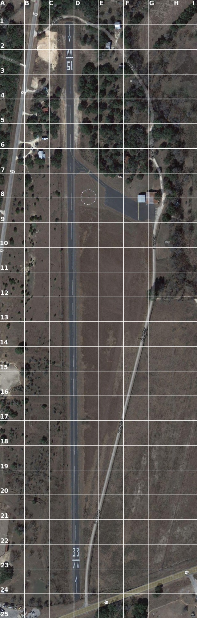

bobk wrote:Hi Sam,
The attachment composite_smoothed_with_grid_numbers.jpeg is no longer available
WHERE IS THE PULLEY?
Re: Tow Patterns
Postby SamKellner » Tue Jan 06, 2015 8:44 pm
uh :oops:
D-23 I was gonna measure it with my gps today but the batteries were low.
That's the location Dave Broyles used for the pulley when he did scooter towing ops here at the Fly-in. I have some really good video of Dave towing PG with D. Prentice instructing the students. They were getting high enough at ~D-17 to release, turn on downwind, do a base leg and final, landing back at the start D-9, similar to the Hollister example #7, down wind, base and final.
At this time we have the pulley at 1,000ft.~ E-13 on the grid That's what Mel had me do in Albuquerque at the balloon park.
The OkieSpool is maxed out with 2,200+ft of 1100lb? Spectra. So I can install the new anchor at D-23 but still need more Spectra.
I'm thinking this graphic can help some new pilots understand their objective.
