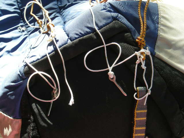

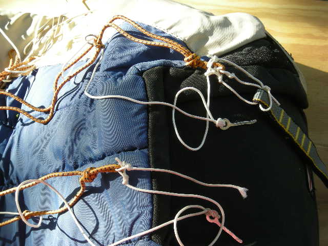

It was a super tow to cloud base ~2500'. As the tow vehicle neared the end of the runway, I glanced down to visually locate the release pin line.
Maybe two seconds later, I felt a normal thump of release and the tow line fell away. WTF ? :?: Mind controlled release ? :wtf:
Here's what was left attached when I landed, as compared to an identical release.

Right, the pictures do not show the 3-loops. I thought sure the loop of smallest diameter line would have been the "weak link". :P That should make a nice quote :srofl:
However, when I purchased these 5 releases ~11yr ago, the maker did say the weak link was indeed the part that failed on my tow, the only one that protected me with a weak link break. ie #1. That's my last new one and I'm gonna need a spare.

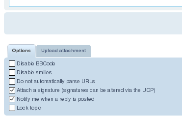

At the bottom of your posting page, there's a tabbed box that looks like this:

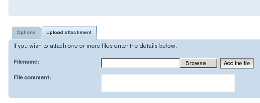

If you click on the "Upload attachment" tab, it will look like this:
If you click on the "Browse..." button, it should bring up a navigation box that will let you find pictures on your own computer. Find the file you want to upload, and then press the "Open" button. That will load the file name into the "Filename:" text area. Then you can press "Add the file" and it will be added as an attachment at the end of your post.

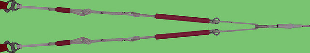

Is that the release you are promoting?

Thanks for that information Tad. Since your current browser has trouble uploading images, I've taken the liberty of posting them here. Let me know if you'd like them integrated into your own post and I can do that as well. Here are the two images:
http://www.flickr.com/photos/aerotowrelease/3313497455/
http://www.flickr.com/photos/aerotowrelease/2337501636/
