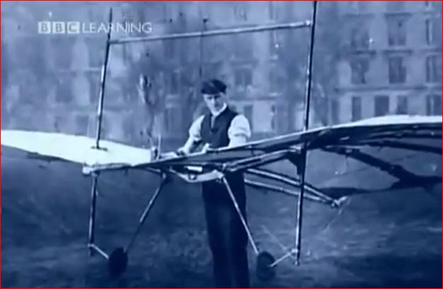

Minimal "high-hat" of a high bar traverse to the wind of flight.
Percy Pilcher's 1897 circa high hat was held by a set of two kingposts.
One may see his high hat as a base for further high hatting structures.
