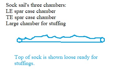

Sock sail's three chambers
To effect some wing stuffing for DS sock HGs, one may want the sock to be triple chambered in some cases: the global main sock chamber, a spar case chamber for LE spar to slip into, and a spar case chamber for the TE spar to slip into. Such sock of three chambers may be one way to control that the lower sail stays taut while the upper sail may be designed with various looseness;the two small cross sectioned chambers are sewn to the sock. The looseness allows stuffing the bird. Some stuffings may press on the lower sail and that pressing may be made less by the tautness of the lower sail. Such challenge pertains to the rough note quoted above in this post. That is, the flat used will be pressing on the lower sail and the upper sail, but because the upper sail has looseness to start, the the arch of the flat will bulge upwards and form camber in the resultant airfoil. So, one would keep note that both upper and lower sail will be affected in shape. Similar shared presses occur in many kinds of other wing stuffings.
