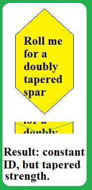

Note how rolling up a flat square rolling from one corner toward the other corner results in a double-tapered beam with the most anti-buckle format in the center of the beam where needed for compression beams. However, a judicious hexagon flat can roll up to a beam that has designed sturdiness at the beam's end. A square rolled from diagonal to diagonal end up with perhaps unsatisfying shape and thinness.

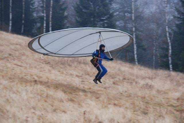

BEF007a seems to live in the shown hang glider.
Now that might be a build project sooner than later to check it out for possible One-Meter-Packed Hang Glider Club membership. The ring at perimeter might be in segments or might be coilable tote format. Multiple tubes might combine to form the final frame; that is, maybe multiple coilable tubes. This might also be a candidate for inflated tube splinted to a CF or glass ring married to the tube.
The history of the shown hang glider seems yet lost or hard to find. Anyone?
Notice the reflex region for pitch stability.
Notice the apparent tail skid (white vertical ring, it seems)

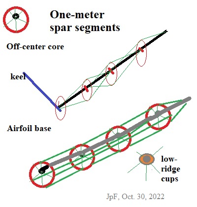

Challenge of side wing using four of one-meter spar segments is wrestled:
One approach using outrigging and lines that double-duty for airfoil forming:
Note: Consider both catilevering or Kp-Qp rigging the complex outrigged spar.
Note: Rib/battens may root to rings.
Note: The whole affair may be a foundation for wing morphing or experimental wing-shape setting.
Note: See how I am off-centering the spar segments so that handling flight-load compression is emphasized; the outrigged lines are further from the spar segments.

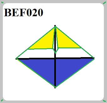

Basic Experimental Frame (BEF) for Hang Gliders may hold the following member: BEF020 may live in Split Wings,
If an experiment has cable-leading edge, then extra care for pitch challenges may be wise.
The first symbol for BEF020 is:
http://www.energykitesystems.net/hgh/pr ... ridge.html

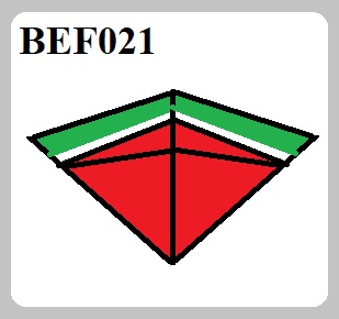

BEF021
https://www.ushawks.org/forum/viewtopic.php?f=22&t=1003
