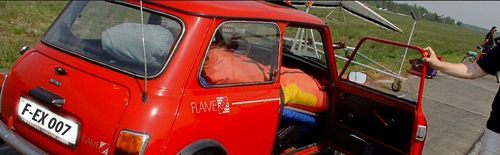

Their "short pack" is longer than the packs in high focus in this topic thread, but one may learn from anyone's effort to short pack, even if tiny pack is not achieved.
One online Bautek text quote: "you can easily short pack them so that they fit into every garage!" The "garage" invite is large compared to "tiny packing.
, I'd surmise." Bautek comments about the bowsprit Astir: "Transport and storage present no problem as the Astir has a short-pack length of 3.00 m (9.8 ft); it therefore fits inside most station wagons." That has a focus that is about twice the size of the tiny packing of this topic thread's maximum; some of us are even aiming for 1 m tiny packing or less; that would put the Astir at about 300% of a 1 m target for packing.
The "Packing the Airfex / Funfex / Perfex / Lightfex short to 1,90 m" video bespeaks and demonstrates 1.90 m "short" packing that resolves the needs of many pilots, but that is about 200% larger than the 1 m in focus for a faction of seekers related to the present topic thread. The Finsterwalder-Charly https://finsterwalder-charly.de/en/hang ... ories.html "short" packs are certainly with pleasant histories and stories of fliking (fly and hike).
