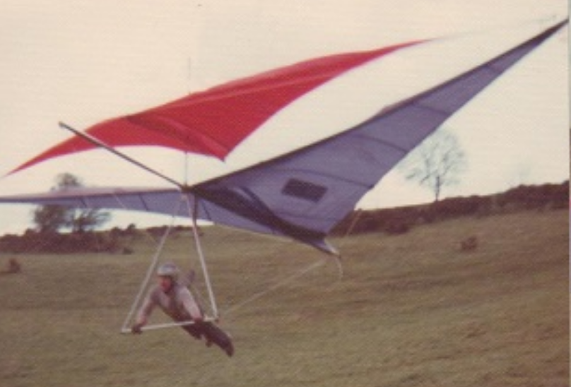

Postby ARP » Tue Apr 18, 2023 3:31 pm
MarkII 001 (2017_12_30 17_34_37 UTC).jpg (211.67 KiB) Viewed 2631 times
This arrangement worked well with no problems with pitch stability.
ARP
Posts: 280

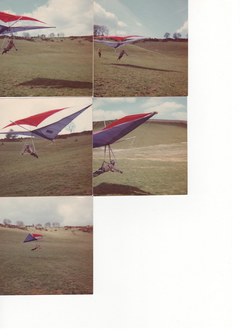

Postby Bob Kuczewski » Tue Apr 18, 2023 8:15 pm
That's a beautiful wing Tony. This shot is my favorite:
Posts: 8966

Postby ARP » Wed Apr 19, 2023 4:25 pm
That shot is with my brother flying it. He was around 210lbs or a bit more at the time. I'm flying in one or two of the photos wearing the yellow jacket but weighed around 170lbs then. Latest version will hopefully tested soon.
ARP
