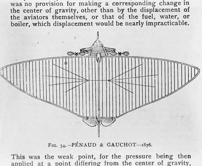

1876

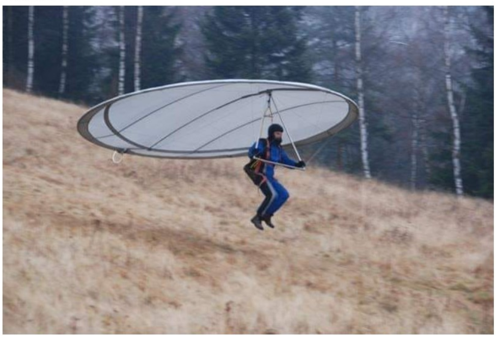

Would this be included in the TDHGC? Flying saucer HG? Disk HG? Circle HG?
https://ushawks.org/forum/download/file.php?id=12972
Toward solutions in TDHGC

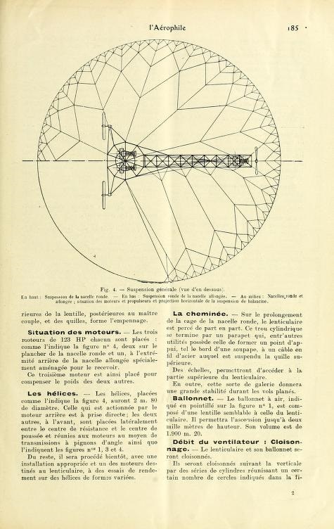

l'Aerophile
L’Aérophile ("The Aerophile") was a French aviation magazine published from 1893 to 1947. It has been described as "the leading aeronautical journal of the world" around 1910.
https://www.loc.gov/rr/scitech/trs/trslaerophile.html For researchers.
And https://gallica.bnf.fr/ark:/12148/cb344143803/date

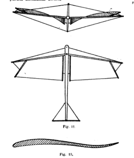

Rigging study from early L'Aerophile:
Filler. 1910. Rail launch. Clip from issue of L'Aerophile, January 15, 1910.

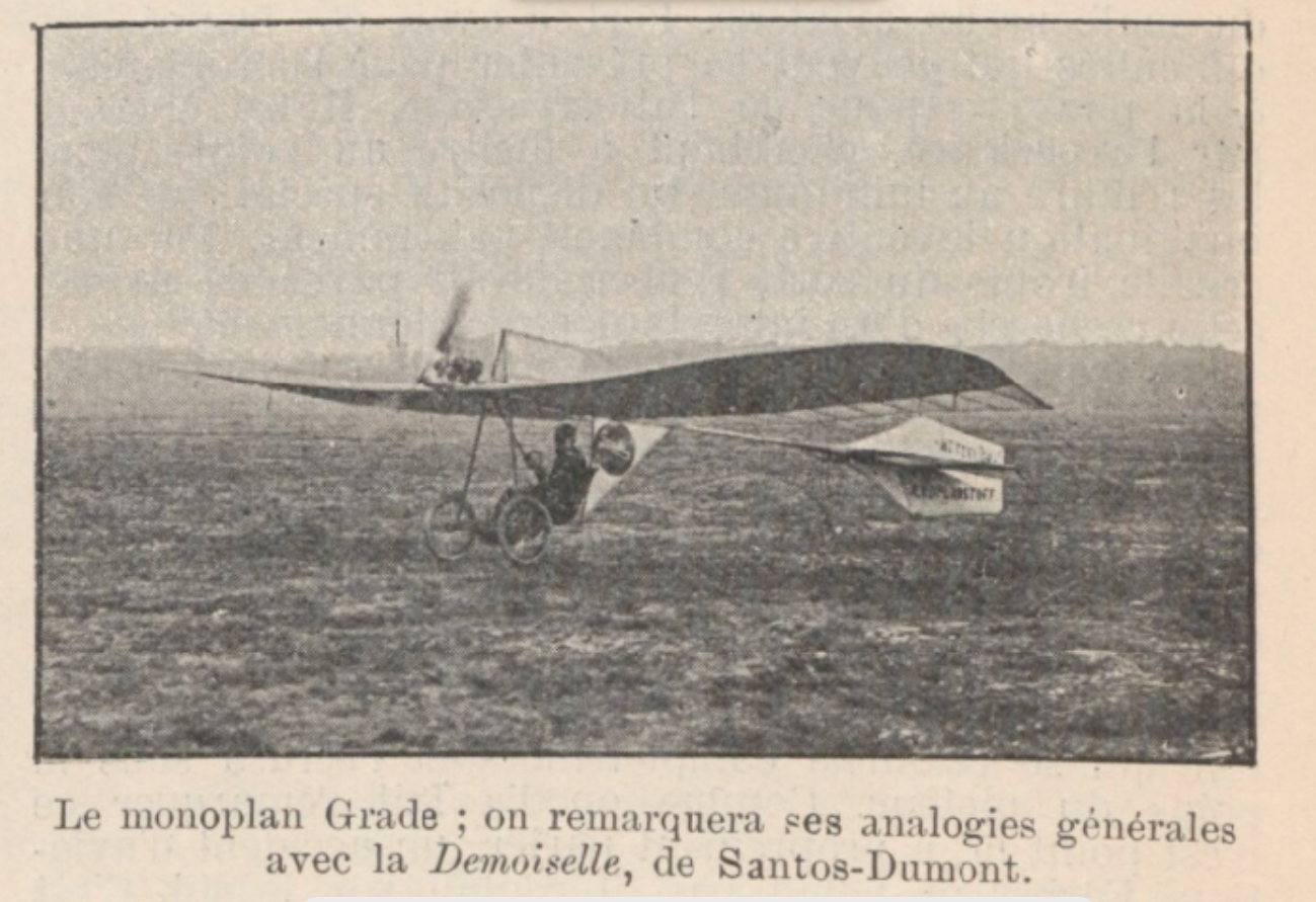

Clipped from 1909 L'Aerophile regarding Grade monoplane

My answer to the question at the top of the above post about the tensegrity membership in TDHGC for the HG in the first photograph shown in that post is "yes." Notice that the disk HG has not a kingpost but does have two queen posts. Note that the sail is pressed by the queenposts. The sail is a broad set of tensed lines; the lower flight rigging lines pull the ring frame member while the two queenposts are pressing the sail; the queenposts are held in space only by lines (though the sail is a set of lines in tension; the flight lines are in tension during flight. The ring frame member is floating only via tensed lines. Thus the core of the wing is a tensegrity deal. Let the central rib be seen as a spreader of compression to tense the sail.
No-kingpost tensegrity:
