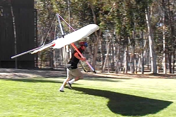

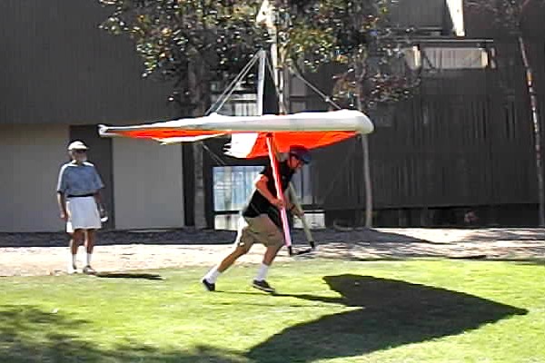

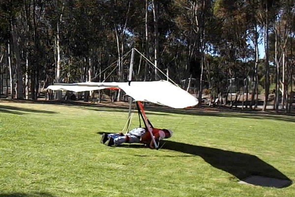

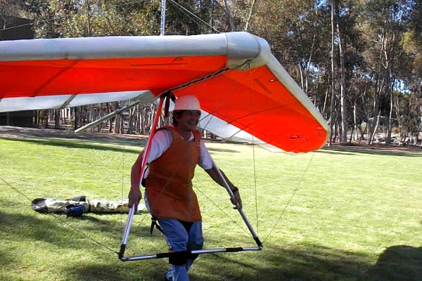

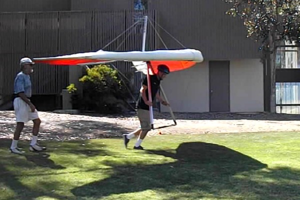

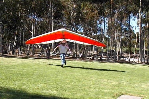

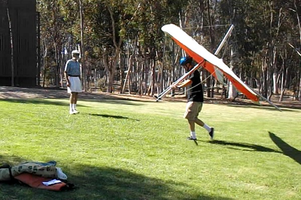

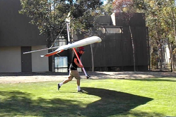

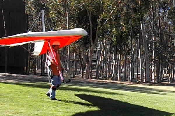

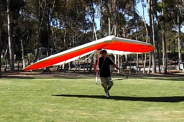

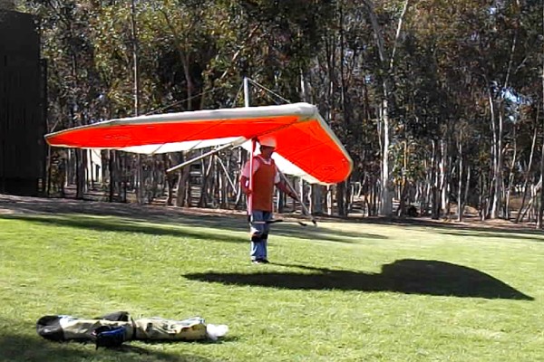

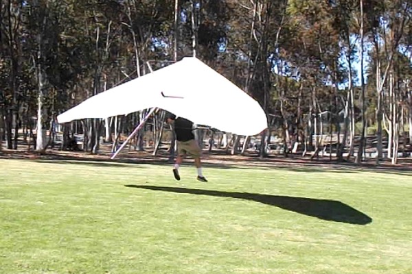

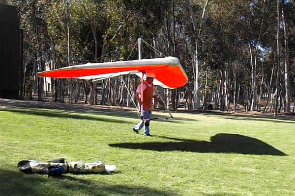

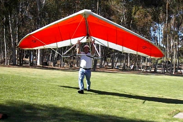

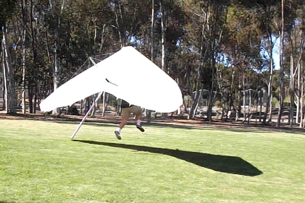

Willy and I took Little Hawk to UCSD for some local outreach ...
We started with a few demonstration flights (no harness)
Then it was "hands on" for the students ...
Finally, I demonstrated the harness with the glider ...
It was a fun day.      :thumbup: :thumbup: :thumbup:
