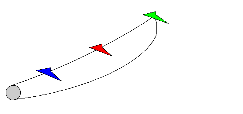

Hi Joe,
Does it look anything like this crude animation?

Postby JoeF » Sat Nov 15, 2014 1:51 pm
Yes, BobK, you captured the essence of one embodiment of the instruction. Thanks for the illustrating teaming! The Escalator AWES (airborne wind energy system) may be faced by illustrators in many ways. Multiple loops, various wing types, option of upper lifter sub-kite system (that may be a kite train, if wanted, or other). Your illustration gives first heart to the disclosure. :clap: :clap: :clap:
