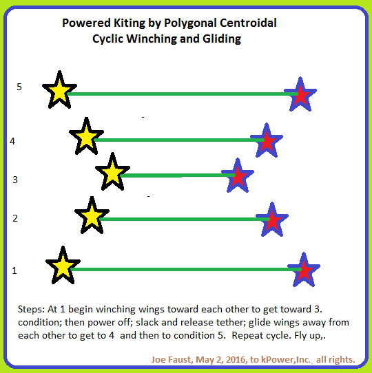

This topic thread will explore use of a certain novel method of flying for the purpose of launching one or more hang gliders into free flight. The first disclosure of the novel method of flying was posted in AirborneWindEnergy form. The first title of the general method: Powered Kiting by Polygonal Centroidal Cyclic Winching and Gliding. The general method may be applied to involve hang glider wing as payload or as participant in the flight up to the point of full release of the hang glider.

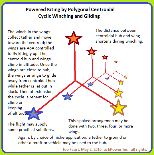

How might the method work? There are two dominant geometric arrangements, but other spider-web arrangements and other nets are to be explore. The two dominant simpler arrangements are the spoked arrangement and the polygon perimeter arrangement. The nodes or satellite wings at the end of the spokes or at the vertices of the polygon are equipped with powered winches. The spokes are tethers; or the perimeter edges of the polygon are tethers. Tethers connect from one wing to another.
When the winches are powered to collect tether, then the wings are kited; the polygon get smaller during the kiting phase. Once the kiting occurs and the centroid is close enough for comfort, then the many wings (two or more) stop powered winching; then the wings glide out away from the centroid (or some other point interior of the implied polygon). During the glide out some of the wings in the system may utilize updraft or be affected by downdrafts or other turbulence. When adequate gliding has occurred, then the system of wings may begin powered kiting again toward the centroid of the implied polygon or some other chosen point interior of the large implied polygon. The powered kiting will aim for another cycle of kited climbing up into the atmosphere.
One simple example of the method may be illustrated by having two hang gliders at the end of one tether. The hang gliders are facing each other. The long tether connects to the winches in the hang gliders; or one might choose to have no winch in one hang glider and a winch in the other hang glider. Begin operations: start the winching; close the distance between the two hang gliders during the kiting; both hang glider are being kited together; each hang glider is effective anchor to the other hang glider; they both climb up away from the surface of the earth. Once the tether is shortened enough, then the hang glider glide away while slackening the tether; the hang gliders soar as they might while still connected by a slackened tether; then upon reaching good distance from each other, the powered hang glider (or both) begin the cycle over again with a powered kiting phase; they then kite up more. Etc. No propellers; no jets; no rockets; no balloons, but just winching for the special kiting format. Then in this simple case, the two hang gliders may decide to cut free; one of the hang gliders would be given the line and the line would be collected into the hang glider. Off to soaring adventures they could go. Two hang gliders would then be into free-flight.

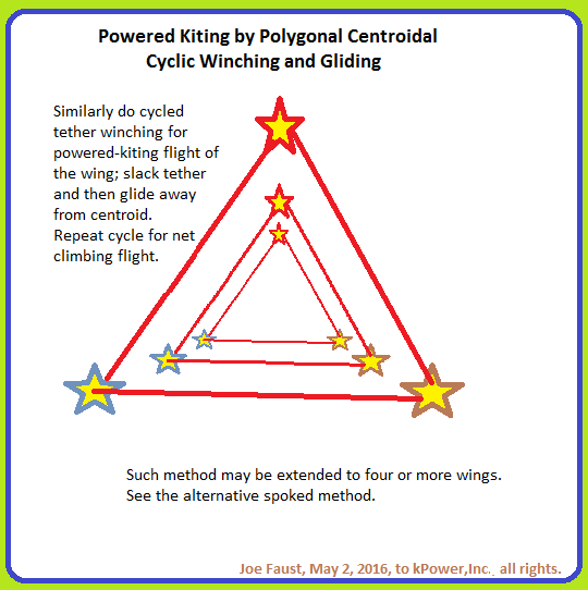

Three hang gliders could be tethered together in a triangle with tethers being the triangle perimeter edges. Alternatively the three hang gliders could use the spoke method.
Consider launching 10 hang gliders at once by the topical method; decagon. Climb up and exercise some cycles until desired altitude is wanted. Then release from the method and all ten hang gliders go into free-flight gliding/soaring.

Having done "Step Towing," I can see where two expert step tow pilots could winch toward each other, connected to nothing but each other, completely unattached from the ground.
Problems to solve would be staying almost perfectly choreographed. (wing loading and everything else considered.)
Flying away from each other and reeling out the line for the next convergence tow cycle would pose problems.
1) If you exhausted the length of towline before turning back toward a nose to nose orientation for the next tow cycle.
2) If the reel(s) failed to let out line while in a tail to tail orientation, flying away from each other.
3) Not dipping the inside wing down under the towline when turning back to a nose to nose orientation for the next tow cycle.

Assuming the simple case of two HGs terminating one long tether line:
Tug-of-War. The line tension does not know the title of what is occurring at the ends; the line simply knows that it is tensed; if the line is tensed at 60 lb then there is is pulling on each end wing of 60 lb, but in opposite directions, thus tension. In Tug-of-War a different matter determines winner or motion past a point in the frame of reference: friction. The HGs will lift-drag for a resultant; motion relative to the frame will be equal or unequal depending on the friction of the two wings; if the friction of HG#1 is exactly equal to the friction of HG#2, then assuming full wind calm, the ground trace would be at equal speed. There would be a closing speed: HGs approach one another at a closing speed; but the apparent wind for each hang glider would be about half the closing speed. Consider pairing Falcon III HG with Boeing 707 with engines off as one HG; have 60 lb tension in the line; the closing speed is the same for observer in the 707 cockpit as it is for the pilot of the Falcon; ground trace in calm: 707 might have so much friction on the ground, that its ground trace might be negligible while the Falcon would have significant ground speed; the 707 in calm would not fly; the HG would know the 60 lb maintained by the winching as ground trace and speed would see the HG kited.
In case of the two nearly equal HGs, the closing speed closely matches the amount of line that is being collected on the reel(s) while both HGs see the 60 lb tension; since the "anchor" to one HG is sliding through the air, then the amount line being collected is about twice the amount of line that would be collected if the "anchor" was not sliding through the air. Say HG#1 needs 20 mph apparent wind and HG#2 needs apparent wind of 20 mph; they would close to each other at 40 mph approximately. Still assume calm air (but once equilibrium is reached off the ground, then wind won't matter anyway for the HGs; they just need to close relative to each other at 40 mph. If there is wind, then the ground trace of the system would net downwind; this note does not face differential turbulence for the separate wings. So, have clear airspace downwind of the operation.)
Note on the tether: It seems during the operation of the two-equal-HG case, that the line is experiencing no apparent level wind, but a vertical apparent wind related to system-climb-rate while only the HGs are experiencing apparent horizontal wind. Upon equilibrium while winching is occurring the system is going downwind like a climbing floating balloon. The system climb rate does set up a traverse apparent wind on the exposed coupling line.
Bill seems correct that splitting to two winches splits the line take-up rate for each winch; each winch taking in line at 20 mph would give the 40 mph closing rate. Having just one HG equipped with winch would have that one winch taking up line at about 40 mph.
