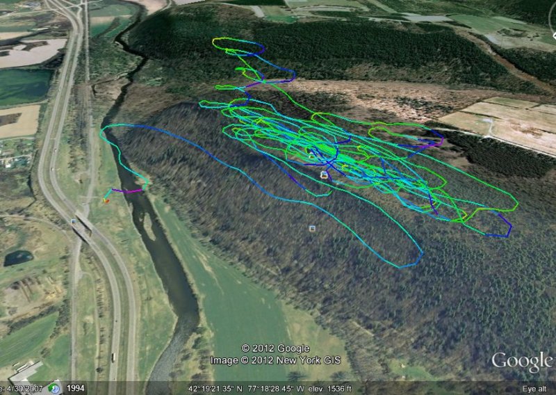

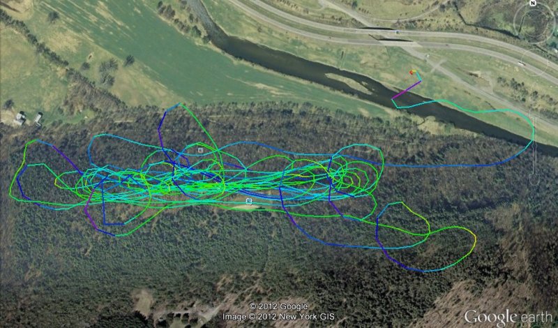

Also, you asked if I could post the Google Earth images (of my not so good flight) with the color coding set for speed rather than altitude. Take a look below. I've taken two screen capture images from different angles. This allows for a better perspective on the situation.
The purple parts are the high speed sections. The last one shows up just before my not-so-good-landing and, before that, in a small section when I'm nicely above the hill (turning down wind). Typically, my higher ground speeds fit with down wind (southerly) headings and the slowest ground speeds fit with northerly headings. This all makes sense since the day's winds were blowing from the north. But then, that last high speed section (52 mph ground speed at about 100 feet high!?) seems to fit only if I was in a W - WSW air flow. Yikes, where did that come from? Something quirky happened.

732 6/13/2012 4:53:35 PM 1311 ft 86 ft 0:00:02 29 mph 272° true N42 19.477 W77 18.492
733 6/13/2012 4:53:37 PM 1294 ft 93 ft 0:00:02 32 mph 263° true N42 19.477 W77 18.511
734 6/13/2012 4:53:39 PM 1279 ft 92 ft 0:00:02 31 mph 260° true N42 19.475 W77 18.532
735 6/13/2012 4:53:41 PM 1268 ft 88 ft 0:00:02 30 mph 273° true N42 19.473 W77 18.552
736 6/13/2012 4:53:43 PM 1260 ft 82 ft 0:00:02 28 mph 338° true N42 19.473 W77 18.571
737 6/13/2012 4:53:45 PM 1224 ft 152 ft0:00:02 52 mph 64° true N42 19.486 W77 18.578
738 6/13/2012 4:53:47 PM 1175 ft 138 ft0:00:02 47 mph 62° true N42 19.497 W77 18.548
739 6/13/2012 4:53:49 PM 1182 ft 89 ft 0:00:02 30 mph 347° true N42 19.507 W77 18.521
740 6/13/2012 4:53:51 PM 1139 ft 32 ft 0:00:02 11 mph 291° true N42 19.522 W77 18.525
741 6/13/2012 4:53:53 PM 1126 ft 12 ft 0:00:02 4 mph 239° true N42 19.523 W77 18.532
742 6/13/2012 4:53:55 PM 1128 ft 5 ft 0:00:02 2 mph 228° true N42 19.522 W77 18.534
743 6/13/2012 4:53:57 PM 1128 ft 4 ft 0:00:02 1.3 mph 226° true N42 19.522 W77 18.535
744 6/13/2012 4:53:59 PM 1128 ft 4 ft 0:00:02 1.3 mph 169° true N42 19.521 W77 18.536
745 6/13/2012 4:54:01 PM 1128 ft 7 ft 0:00:02 2 mph 138° true N42 19.521 W77 18.535
My math may be fuzzy but I figure you had about 41 mph airspeed pulled on. (@ 1,224’ msl?, with a 10-11 mph wind from the westerly direction.
31 mph ground speed into the wind and 52 mph ground speed downwind. (064 degrees).
Your downwind leg speed over ground goes from 52 mph to 47 mph resulting in a 7 foot gain in altitude. This could be a stick thermal or could well have been caused by the overpass upwind.
I’m thinking your airspeed was now 34mph. Giving you a over ground speed of 30 mph in the crosswind-upwind leg of 347 degrees track.
If the wind on the ground was zero or slightly more that could have put your left tip during the turn, onto track 291 degrees, with less than 34 mph.
Do I need to go back to math class?
Good job in fighting your way back into the prevailing wind. Down wind is usually brutal.
Re: My Last Flight (accident report) - and My First One Sinc
Postby wingspan33 » Sat Sep 15, 2012 11:45 am
Thanks for the reply Bill!
I think your analysis is close to right on. What I originally did was simply look to see (on the flight's GPS track log) what I could not remember because of the jarring my head took. I solidly remember planing a different and specific approach for my landing. However, the GPS track log revealed that I altered that approach. I have no memory of why I did so.
I also noted that during my final few seconds in the air, I was losing altitude much faster than should have been expected. The track graphic in Google Earth revealed that clearly. In fact, I lost 85 ft. in about 4 second's time.
But at the same time that I was losing that altitude, my ground speed was indeed quite swift. And conditions weren't such that I had much chance to have encountered a 25 - 30 mph westerly tail wind (which would have resulted in a stall - which is one way to explain the quick 85 ft loss in altitude). That leaves mechanical turbulence and I suspect some form of rotor induced downward air flow. This could have come from a freaky cross and down wind air flow off the hill, or a powerful thermal ripping off just beyond my area of the sky. This last situation could have drawn air downward from around the area surrounding the base of the thermal release "zone" - resulting in the apparent serious sink that I believe I must have been encountering.
As to the 7 foot altitude gain, I hadn't noticed that. But where that was, was between the transition from the ground speed reading of 47 mph and the next reading of 30 mph. Note, that at the same time that I am gaining a small amount of positive altitude, I am also "losing" 17 mph of ground speed. This is because I was involved in my turn back toward the west. With my excess(?) ground speed (52 - 47 mph) just before this point, I would guess that the 7 foot "bounce" could have been connected with a quick transition back into a head wind (a stick thermal without having to move the stick).
But it could also have been associated with a change in the very local air mass at this lower altitude. It may have been denser (cooler?) or the air might have been "bouncing" off the ground after down washing as a sinking air mass. I have very clearly encountered this kind of effect in the past, but it has always been within 10 - 15 feet of the ground. So, I think that it is acceptable to bet on my slight altitude gain as being the result of the transition from going fast down wind to swinging that gathered kinetic energy around back into the wind. An effective "stick thermal".
Also, in doing some subtraction involving my altitude loss between (2 second interval) GPS readings, I get -
(During the final moments of my flight)
- 36 ft
- 49 ft
+ 7 ft
- 43 ft
- 13 ft
In 10 seconds (on a topless wing) I lost 141 feet of altitude.
In another 10 second sample during my (sinking - not soaring) glide about a minute before landing, I lost only 38 feet.
There was something unusual going on during that last section of my flight. Some kind of seriously sinking air, is probably a good guess.
