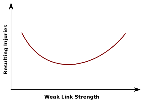

As another suggestion, I think the notions of balance and pilot choice should be introduced at some point. The curve of injuries as a function of weak link strength probably looks something like this:
That means there's danger on either end ... and even at the lowest (best) possible point!!
However, the shape of that curve for any particular pilot is based on their choice of equipment, conditions, and their own pilot skill. A pilot with good skills at recovering from weak link breaks (as Bill mentioned above) will be operating with a curve that's much lower (less chance of injury) on the left side than a pilot with poor skills at recovering from weak link breaks. Similarly, a pilot using a good quality release will be operating with a curve that's lower on the right side than a pilot using a poor release.
In the end, I think the best weak link strength will be based on the combination of equipment, conditions, and pilot skill. So one of the goals of this chapter should be to show the full range of those issues so the individual pilot can be educated as to how to weigh them in making their own choice of weak link strength. It's important to remember that the safest weak link strength may differ between two pilots even if they have the same weight, equipment, and conditions. Their skills matter, and I think that is very well said in Bill's post.
Great topic and discussions Bill, Sam, Mike, and Charlie!!!

My entire hang gliding towing experience consists of one tandem aero-tow at Wallaby Ranch ... where I was the passenger (thanks for the flight Malcolm). So my comments come more from an attempt to understand towing than any pretence of authority on the subject.
One of my thoughts while mulling this all over is that the severity of the glider's response to a line break must be related to the amount of tension in the line when it broke. In other words, if the tension is very close to zero before the break, then the glider's response will be very close to zero after the break. Is that generally true?
Similarly, if the tension is very high at the time of the break, then that means that the force diagram before the break shows a large force along the tow line and an equally large force opposing it. At the moment of the line break, the tow line force becomes zero, and the opposing force is converted to acceleration (actually deceleration in this case) according to Sir Newton's F=ma. So the greater the line tension at the time of the break, the greater that thrust change and subsequent deceleration will be. Is that generally true as well?
Thanks for the great discussion. It's great to see all aspects of a topic like this being explored!!

Thanks Bob for putting into words what most accurately describes why I think the way I do on this subject.
Quote: Bob K.---
“One of my thoughts while mulling this all over is that the severity of the glider's response to a line break must be related to the amount of tension in the line when it broke. In other words, if the tension is very close to zero before the break, then the glider's response will be very close to zero after the break. Is that generally true?”
I believe that is true.
Quote: Bob K.---
“So the greater the line tension at the time of the break, the greater that thrust change and subsequent deceleration will be. Is that generally true as well?”
I believe that is true also and the two quotes are the basis for my way of thinking.
