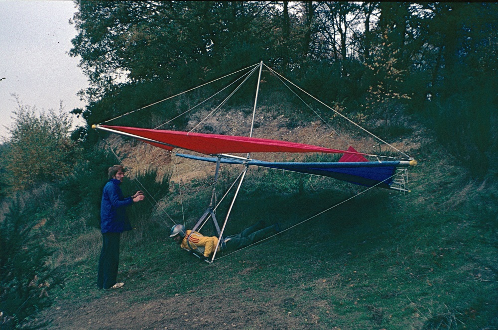

Postby ARP » Sat Feb 20, 2016 1:13 pm
Attached picture shows wing at rest and top rigging under tension.

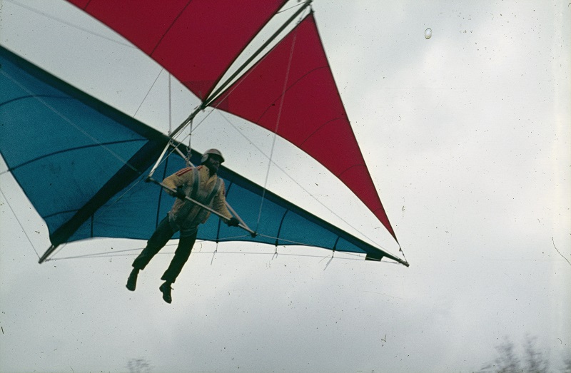

Postby ARP » Tue Feb 23, 2016 4:39 am
The attached picture shows that the Split-Wing main sail could be adjusted by the ties on the trailing edge to the rear rigging cable. The Porta-Wing uses a similar rear rigging cable which might allow for the same arrangement? However the amount of sail billow would make it difficult to get the correct alignment.

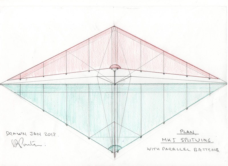

Re: Vintage "WHITNEY" Hang Gliding Sales Brochure & 4 Photos
Postby ARP » Tue Mar 01, 2016 2:09 pm
Frank,
Here is a modified plan view showing the addition of battens in both main and jib. I used 2" o.d. 16guage aluminium HT30TF (drawn). !7guage should be OK and allows telescoping of tubes for sleeving and reinforcement. If you use HG tubing as close to the sizes as shown it should be fine.
Span is 30' and keel is 17'6".
As I will have no control over build or materials used no liability is accepted by me or guarantees offered to its suitability for flight, etc.
Postby KaiMartin » Tue Mar 01, 2016 3:31 pm
ARP wrote:The attached picture shows that the Split-Wing main sail could be adjusted by the ties on the trailing edge to the rear rigging cable. The Porta-Wing uses a similar rear rigging cable which might allow for the same arrangement? However the amount of sail billow would make it difficult to get the correct alignment.
The configuration of sails at the split-wing differs significantly from the way they are arranged on a sail boat. The jib of a dinghy does not align with the main sail. While both sails are set to about the same angle of attack, they are shifted down wind. The clew of a jib tends to be fixed about half the sails a cord downwind of the mast. Most modern designs pull the aft of the head sail even further to the stern and fly a genua. See the rig of a flying dutchman:
As you can see, this arrangement results in a biplane configuration with the two sails stacked above each other rather than down wind. The flow field of the sails is closely coupled. As a result the pair can be operated at higher angles of attack than separated sails.
If a split wing is intended to benefit from the same aerodynamic effects as the main sail/genua combo it should probably go for a more stacked position of the wings. I am not sure how this would affect pitch stability. Thorough analysis and model testing would be mandatory.
Postby ARP » Tue Mar 01, 2016 3:52 pm
Kai,
Yes various positions for the jib/Genoa were tried and they all worked. The latest design I am working on does overlap by quite a bit. The jib/Genoa are near full span but the Mk3 is about half span but uses tube rather than cable L/E. The Mk1 sails were not on the same alignment, as the keel angle provided the biplane separation, which still provided a close coupling, enabling high angle of attack without stalling.
Mk 2 attatched:-
Mk III.pdf
(256.2 KiB) Downloaded 343 times
MarkII 001.jpg (211.67 KiB) Viewed 4886 times
