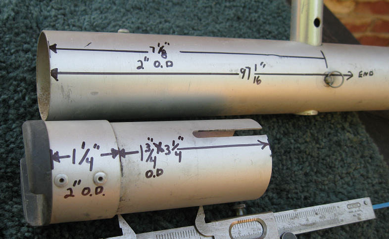

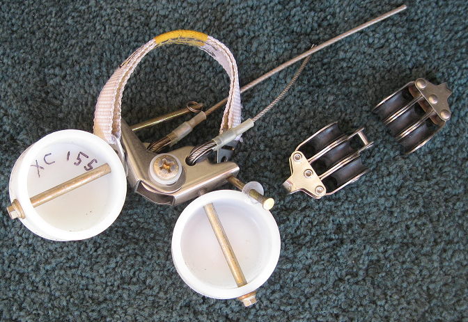

Well now I'm :?
Is there such a wing as a Fusion XC - 155 :?:
I still haven't come across a Rocker hang block yet but now I'm wondering if it was a Fusion that I helped Ole part out or something else.
If the picture below is of Fusion parts there is still hope I have a Rocker hang block ---- SOMEWHERE
Are these Fusion Parts.PNG (886.22 KiB) Viewed 4461 times

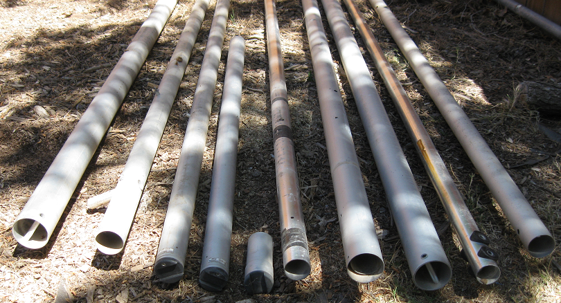

LATER EDIT
Part of the level one search included a trip to the boneyard. There was a time when I was younger that I could have walked up to this assortment and pointed out each part and identified it.
So now I put on my glasses and inspected each tube for factory identifying writings only to find NONE.
I'm thinking -- how stupid was that?
Now I'm thinking how stupid was I to not label each part as I disassembled possibly --- well ---now I don't remember how many gliders?
Exact parts.PNG (1.04 MiB) Viewed 4460 times
Anyway still no Rocker hang block.

This is not the shortest way to an answer, but . . . Wills Wing manuals give dimensions for each frame member. If you have Fusion parts, then they will match up to one of the (2 or 3?) size Fusions in the manual.
But, also, WW did make a glider model called the XC (Cross Country). A Google search turned it up in seconds. Down load an XC manual and it may also confirm, by dimensions given, that you have an XC frame.

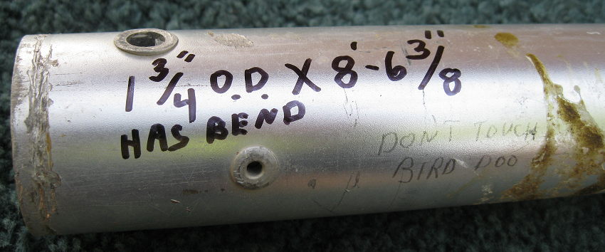

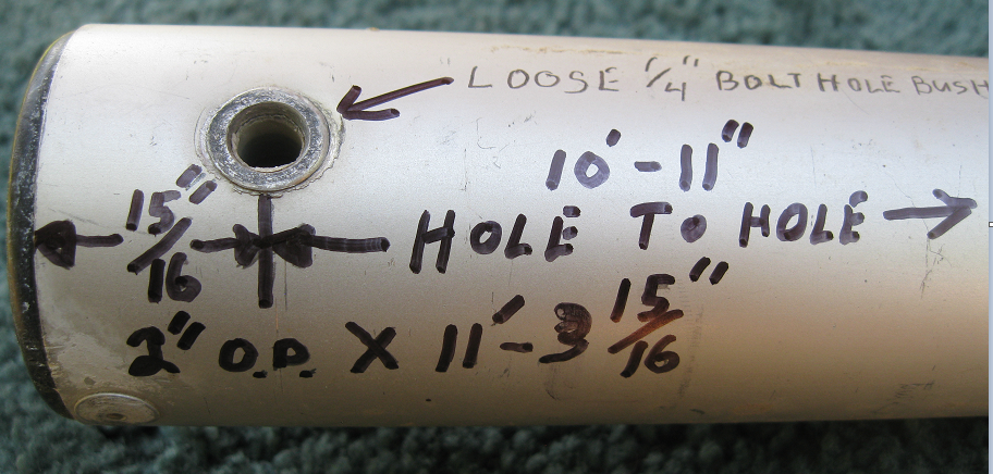

Scott,
I measured and marked some Aluminum tubing that I have here except for the really big diameter tubes like they used for HP2 corssbars.
Since I'll be giving you the part you need and there will be no commerce here I guess it will be okay to post my used parts pictures. Let me know if we can connect you to something that will get your Fusion back into shape.
By the way PM's don't have picture attachments. So I'll post the pictures here.
(sometimes the pictures will not fit on your screen and it may help to hold down the Ctrl key and then click the minus (-) key.)
Leading Edge 1.PNG (966.4 KiB) Viewed 4411 times

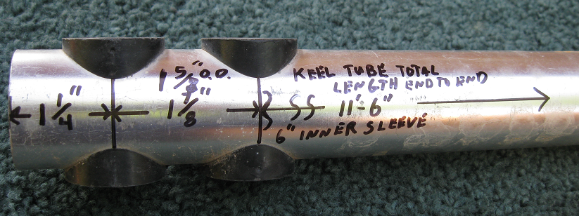

Trailing edge with plug 3.PNG (997.52 KiB) Viewed 4411 times

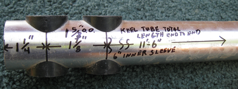

Keel 4.PNG (620.89 KiB) Viewed 4411 times

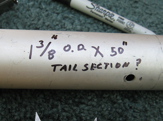

Leading edge has bend 5.PNG (749.81 KiB) Viewed 4411 times
Tail section 6.PNG (542.75 KiB) Viewed 4411 times

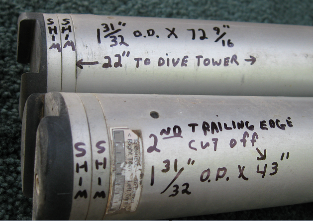

Trailing 8 edges..PNG (700.03 KiB) Viewed 4411 times
Let me know if you need the larger diameter tubes measurements.
Let me know if the picture is cut off in width and not showing all of the measurements.
