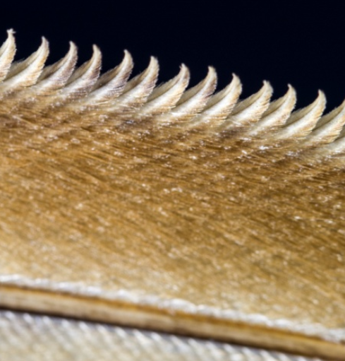

Postby Bill Cummings » Tue Apr 19, 2016 9:12 am
We might need a beak to align and attach the little hooks on each feather with the adjacent feather.
Also synthesize bird gland oil for feather maintenance. (This might be difficult.)
Run your beak down the length to engage with next feather..PNG (576.16 KiB) Viewed 5708 times

billcummings wrote:We might need a beak to align and attach the little hooks on each feather with the adjacent feather.
IMHO, it is hopeless to try and copy the microscopic structure of bird feathers. This would require a degree of three dimensional micro structuring which is well beyond any technology currently available outside of certain high level material science labs. And even they struggle to produce more than some precious tiny samples. A hang glider needs like 15 m² wing area. Even totally available high tech materials may just be prohibitively expensive.
To me, barbs and barbicels do not look like necessary requirement for feathers to do their aerodynamic job. They are just the ingenious solution mother nature came up with, given the tools she had. So what is the aerodynamic job of bird feathers in the first place? IMHO, it boils down to:
