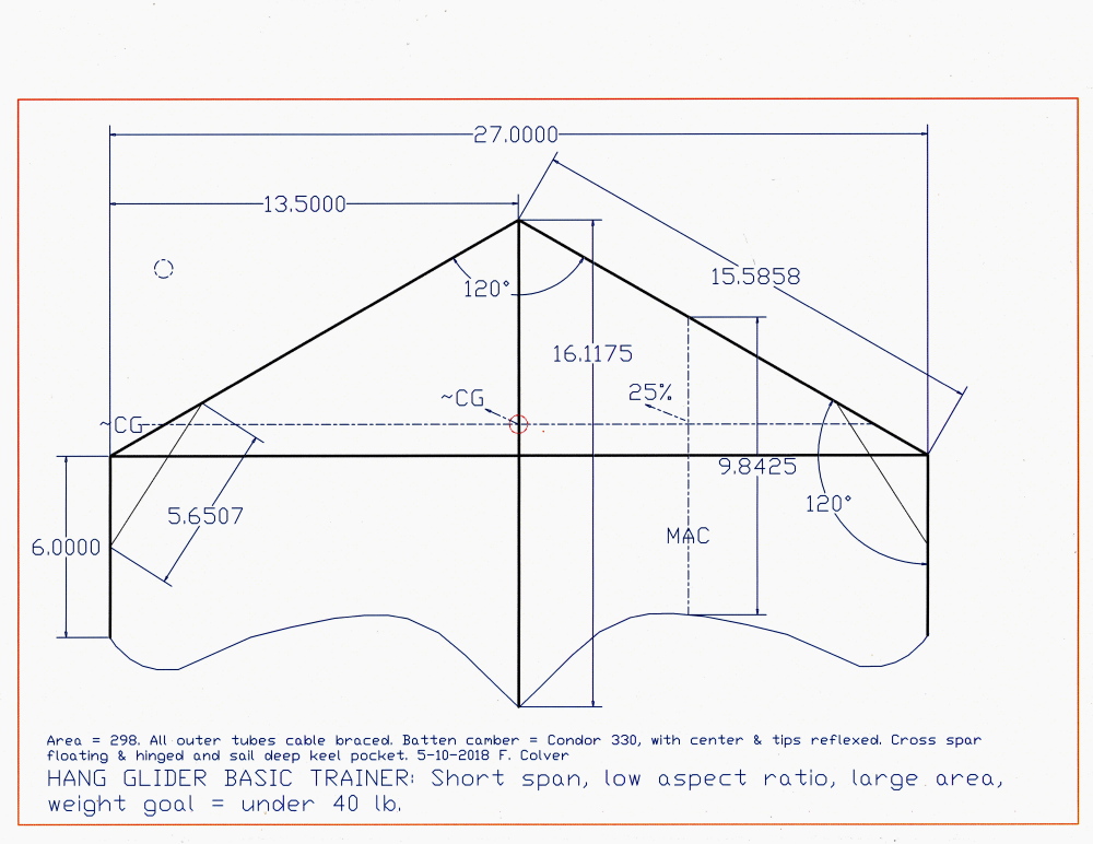

Using a geometric approach shown to me by Mike Meier at WW I have approximated the CG of my basic trainer glider design. There will be more error in my calculations because my sail is not cut in the straight line at the TE. To be more accurate I would have to come up with the straight line equivalent of the area back there.Mike showed me how to find the Mean Aerodynamic Chord and then set the CG at 25% of that chord line. This should get me into the "ballpark" for the initial tests so that the CG is not way off to begin with.
I'm getting close to building the 1/5 scale flying model.
Approx CG location.
Basic trainer approx CG .JPG (235.96 KiB) Viewed 12868 times

I see you have increased the truncated portion compared to the initial drawing sent to me via email Frank. As a matter of observation, I also see the truncated portion, the leading edge, and the crossbar all share a common junction point. Also, the crossbar is drawn straight across.
I have two questions so far.
1. Is the crossbar going to be divided and floating like current hang gliders?....and
2. How are you planning to join the crossbar, leading edge, and truncated portion? I can imagine a regular type junction for the L.E. and crossbar but with the junction plate extended on the truncation side to provide a "pivoting point" for the truncation....so all three tubes are actually joined by a single plate?
3. If the crossbar is going to be floating, and the truncated portion is also going to be foldable, I see a fairly short package if this is the case. If the truncations could fold to lie parallel with the L.E. the disassembled glider will not be much longer than the keel itself....and only 40 pounds?

I am sure you have your own plan for holding the truncations in the "flying" configuration....to hold tension in the trailing edge and to determine washout, etc. etc......
Since all three tubes are coming together at one point (the L.E., the truncation, and the crossbar)....I can see multiple possibilities....
Any of the ends of those three tubes.....the rear of the L.E., the front of the Truncation tube, or the outside ends of the Crossbar, can be extended beyond the junction of all three to provide a point of attachment

I think I mentioned somewhere that the cross spar would be floating and foldable but maybe it was just in my head. I was thinking I could buy the ball and socket joint from WW and modify it if it didn't fit the tubing I use.
As far as folding goes I just have a general idea floating around in my head. The truncated tips would have the diagonal braces removed and then folded inward along the LE's. I'm hoping that with a "noseplate" type of junction at the place where the tips, cross spar, & LE come together I can get a configuration where all of those can fold together. This is something I can physically model to try different things if I can't work it out in AutoCAD. The "fly in the ointment" will be how much room the sail requires as it bunches up against the tubing as it is folded.
For holding the upward twist in the tips I'm counting on cable from the king post. The short span will give me a greater angle of the support cables which will help and I may also have to go with a fairly tall king post. I'll probably need cable to the tip ends from the base tube also. That diagonal brace from the tip centers to the LE's is going to be a very important component that the support cables work with.

I envision the sail tension along the LE's to be a grommet with a line extending out to the corners with the tips to pull tension outward. The ends of the tips could be done the way it is done on current glider wingtips.

2. I bent 6061-T6 1 1/8" by .058 with a 3 1/2" radius die with poor results....switched to a die with a 4 1/2" radius and had beautiful results....so, yes, radius is key for bending alloys such as 6061 and even though bends "harden up" the bends are still plenty strong. I know at least one HG manufacture who bends all his own base tubes in this manner with good results....but, as RED Says....for full strength the tubes should be shipped to the bender on dry ice at zero....bent....then shipped back on dry ice to be heat treated to 6061-T6....that is the BEST way and the ONLY way if a sharper radius is the goal.
But Franks design (In the above drawing) is going to require the standard crossbar/L.E. connecting "plate" regardless and if that is also the point of truncation...well....might as well use the same plate....however...a pre-bent tube as RED suggests would allow more freedom in design and could be attached via PiP pin removed for folding.
