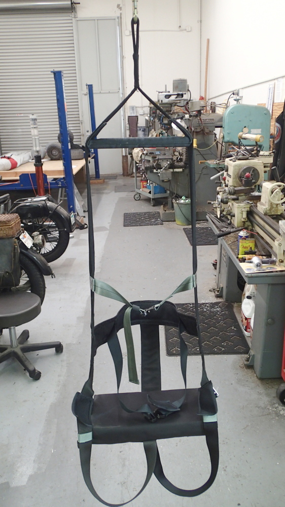

I just picked up the third, and most likely the final, iteration of the swing seat harness at High Energy Sports. All of the small details of things that could be improved, that have been discovered in the first and second prototypes have been changed. This design now appears to be ready for flying enjoyment. The biggest overall improvement has been the narrowing of the seat and the spreader bar. So now, the hang straps closely hug the torso and are well inside the shoulders so that the arms (outside the straps) are completely free to move side to side holding the control bar.
Straps can't twist in the adjusters anymore and the thigh straps have stronger adjusters, certified for use on commercial ride harnesses and parachutes, which also allow adjustment with an easier pull.
So now all that remains is to fly and enjoy and to introduce others to the comfort and pleasure of recreational seated hang gliding. For extended flying at altitude a foot stirrup would be added.
I will be continuing to design the control bar adapter for seated flight on a prone rigged glider. Right now my system needs some fittings to already be on the control bar in order to add the adapter tubes. I'm aiming for a design that could be quickly added to a glider already set up that doesn't have any special fittings already on it. Like Jim's approach with the Fenison Fly Bar for suprone flying. I've got some possibilities for achieving this goal already in mind. Ultimately I'd like to see Jim offering his Fly Bar and my seated adapter bars as a choice for pilots depending on what type of flying they want to do. There is a place for both. Seated is especially good for smaller hill ridge soaring. Especially for watching that tip that is passing within inches of the hillside. :o

Postby Frank Colver » Mon Jul 09, 2018 10:32 pm
Here's a photo of the 3rd and should be final iteration of the seat harness design.The bugs seem to be all corrected and it is a joy to seat in this thing. The hang straps are now in close to the body and chest. With arms outside they don't restrict side to side movement of the pilot at all. I don't expect Joe Greblo to fly this one with one arm inside and one arm outside (the 1st seat, flown at the Otto meet, was way too wide).
The spreader bar is a simple straight bar like they all used to be. The original was 15" wide it is now 12". No compromises for fatheads here!
The straps all adjust with ease and don't twist or curl up in the fittings anymore. As soon as the load is taken off the feet the butt goes onto the padded rigid seat automatically and the thighs horizontal, without any "scooting around" action needed. The natural position of the upper body is a mild leaning back position. It reminds me of an Adirondack chair. Hmmm....where can I put a drink holder on this thing.
Sears and Roebuck, eat your heart out over this baby!
High Energy Sports did an excellent job of turning design ideas into reality.
Frank C.
