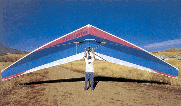

I used Joe Faust's earlier Predator photo (thanks Joe!) to construct a measurement diagram. While the photo is a Predator, I think the same measurements could be made for most common hang gliders. Note that you could use an image like Joe's posted photo as a rough start for building a model. You could measure things in pixels and then convert using known lengths to get actual values. Of course, an actual measurement is best.
OK, here's the measurement diagram. It's an animated GIF that goes through the preliminary steps of defining the origin followed by the 18 measurements listed above (and repeated below).
And here are the 18 numbered measurements to go with that diagram:

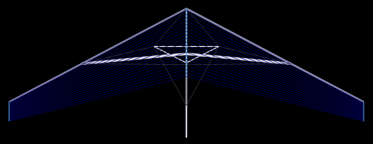

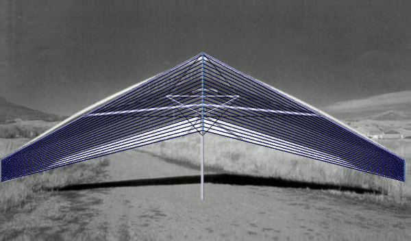

I took "pixel" measurements from Joe's photo and built a crude model. Here's a comparison of that model to the original image:
As you can see, the model doesn't yet support the curvature of the leading edge. But other than that, it's not too bad considering that it came from a single photo. Hopefully we can get some actual measurements soon. I heard from Chris that he did get his Predator at least partially set up. He was thrilled to see it in person again. :thumbup:

Here's my latest Predator model from Joe's posted photo:
'Version': 1.0,
'KeelFrontPoint': [0,94,0],
'KeelRearPoint': [0,-119,0],
'WingTipPoint': [291,-60,6],
'TrailingEdgePercentKeel': 52.5821596244,
'RearWirePercentKeel': 75,
'ControlBar': {
'Height': 65,
'Width': 107,
'ApexPercentKeel': 42,
'RakeDistance': 27,
'CrossBar': {
'PercentKeel': 35,
'PercentLeadingEdge': 59.0060240964,
'HeightAboveKeel': 7,
'KingPost': {
'PercentKeel': 42,
'Height': 50,
'RakeDistance': 3,
'Battens': {
'NumPerSide': 2,
'BattenList': [
'PercentLeadingEdge': 0,
'Segments': 20,
'LeadingEdge': [50,165],
'LeadingEdgeControl': [125,20],
'TrailingEdgeControl': [275,150],
'TrailingEdge': [685,160]
'PercentLeadingEdge': 100,
'Segments': 20,
'LeadingEdge': [225,305],
'LeadingEdgeControl': [240,295],
'TrailingEdgeControl': [283.5,297.1666717529297],
'TrailingEdge': [404.5,318.1666717529297]
You can select that text and copy/paste it into the "Glider Data (JSON format)" window and click "Update Model from Text" to see it and modify it. It should look something like this:
