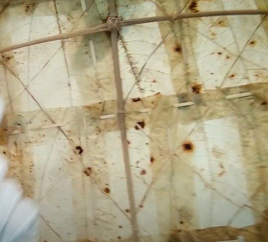

Temporary or permanent cladding of nets for HG sails?
Have a mesh of about 10 cm for a net made of Dyneema string; perhaps tie a triangular meshed net.
Cover the HG with the net. Clad the individual net holes with various materials. Some choices of materials: aluminum foil, discarded plastic bag patches, paper, treated paper, silk fabric, Mylar,Dacron fabric cuttings from sail-loft floor, polycarbonate film, patches of post-party foil balloons, chicken feathers, treated broad leaves from certain plants, etc. The finished HG would have a resultant performance, like it or leave it.
Samuel Johnson on what is a net wrote:any thing reticulated or decussated, at equal distances, with interstices between the intersections
I would allow unequal distances.

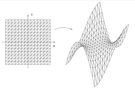

Getting to know nets with an aim to dress a hang glider frame may be a fun adventure in itself. There are many definitions for nets. And various ways to construct a net. Perimeter anchored lines in one direction might be simply overlayed with lines from another direction also perimeter anchored; maybe avoid even "joining" where lines cross; just let the lines be; then clad the holes. Nomenclature will vary depending on the industry using a net. I have personally not yet mastered net nomenclature within any particular industry, so my prose will be immature relative to those who have such mastery.
https://en.wikipedia.org/wiki/Triangula ... ar_network
https://en.wikipedia.org/wiki/Surface_triangulation
Tearing behavior of clads for different nets will be something to observe and note. Repairing a 10 cm torn patch: cut and bond a new patch.
Why? Well, HG are always covered with some kind of sail; and every sail is interpretable as a net, even if it is a single hole filled with a no-hole film of plastic. Dacron sailcloth holes might be filled with a resin to fill the tiny tiny holes of a tight weave, or not. In some sense fabrics are nets. But a full range of nets may be explored for HG coverings. Have we missed some opportunity by incomplete explorations? Wrap complex HG shapes; let the net be custom shaped; then patch up the net holes.

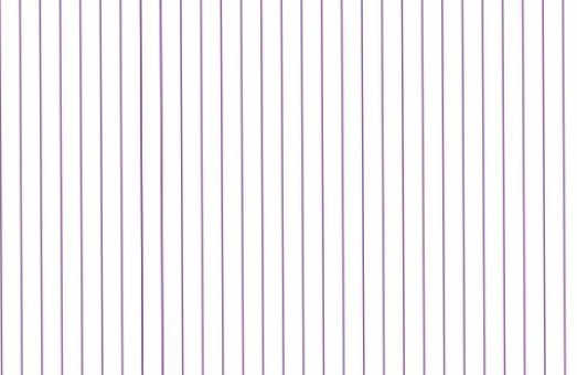

Incomplete nets? Consider just a set of parallel strings from the HG's LE to the HG's TE. Say the lines are 5 cm apart from each other. Have no other lines traversing the parallel lines. In some sense the arrangement results in a kind of incomplete net, until one lets the LE and TE be the traverse members; then the mesh size or hole size of the net consist of very long high aspect ratio holes. Then consider patching those holes with varies ribbons of plastic or fibrous textiles, etc. Such a sail has not the ripstop of net traverse lines. Tearing might occur easily from LE to TE. Sail flight loading will show a bumpy result. What would be the aerodynamics of such a sail? Any takers on this? Maybe not. Next: Analyze spanwise parallel lines of ribbon-fill; results?

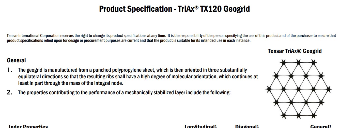

Conclusion for me about the product TriAx Geogrid:
13.1 ft by 246 feet: 115 lb
3223 sq ft for 0.356 lb/sq ft.
So 200 sq. ft >>>> 7 lb for HG sail, assume zero for fill of the apertures (holes, openings) and the involved glue. That is heavier than I want for my HG sail.
The product has sharp edges; gloves are to be worn when handling the product; such all leads to a "No" for me on its use. Too heavy; logistics: too involved. Apertures are smaller than what might meet my aims.
But a triaxial Dyneema constructed net might do wonders; it appears the net would have to be DIY project. Names for the openings in the net: holes, openings, apertures, deductions, .. Holes can be any size when one makes one's own net.

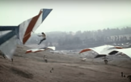

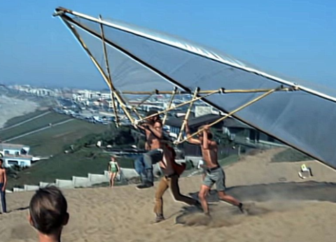

While you're building, why not recreate these originals in a mini version
using very colorful sails of US Hawks design. :P
Sometime in 1970 at Torrance Beach Cliffs.
First Bamboo HG.png (261.36 KiB) Viewed 2302 times

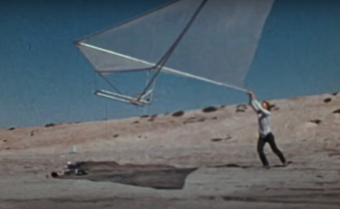

About 1 week after seeing the first bamboo kites, David Cronk came up with this prototype and tested it at Playa Del Rey.
prototype of Hang Gliding history.png (172.47 KiB) Viewed 2302 times
And the rest is history.

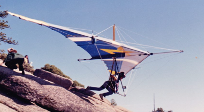

From the Journal of Experimental Biology.
For bird wings there is clearly a trade-off between lift and drag performance. Bird wings with low drag generally had low maximum lift coefficients whereas wings with high maximum lift coefficients had high drag coefficients.
In my H0 opinion, that is why the older kingpost gliders and especially the bowsprit's
Bowsprit magic.png (156.68 KiB) Viewed 2129 times
are the best of both worlds.
I asked my dad once while looking at his 707 wing, "what are those little things coming out of the top of the wing"?, which he said, "those are spoilers, and they try to keep the air, 'stuck' to the wing during flight but add more drag, and the same for the slats and flaps".
To me the "clean' wing of the modern Hang Glider has it's draw backs in that they seem faster and harder to land for the novice pilot.
