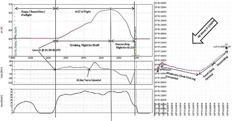

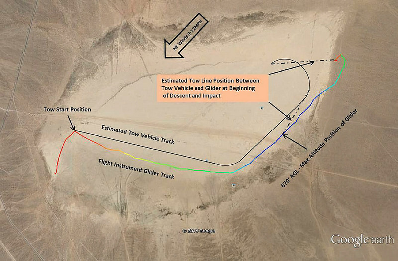

The flight lasted four minutes and seven seconds. During the initial approximate three minutes of the crosswind/upwind leg of the circuit tow, the pilot climbed to 670 feet AGL at between 250-600 fpm climb rates (see Figure 2: Annotated flight instrument data plot).
The tow vehicle then began turning for the downwind leg of the tow as the glider continued flying upwind. During this one minute part of the tow the glider descended to 390 feet AGL at between 0-530 fpm sink rate and the tandem instructor flew to the right of the tow vehicle track as slack developed on the tow line trailing to the left of the glider's flight path by as much as what appeared to be 120 degrees (see Figure 3: Glider and estimated tow vehicle tracks).

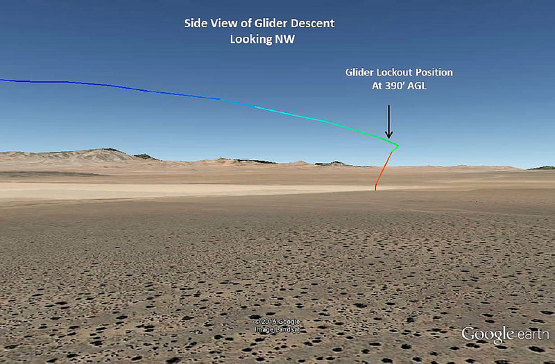

The flight ended with a nine second lockout and impact with the ground. The lockout developed after slack quickly came out of the tow line and the bridle came into contact with the glider's control frame. The glider was at 390 feet AGL with the towline appearing to angle approximately 50 degrees left of the glider's flight path. The tow bridal first contacted the outside edge of the wheel adjacent to the left corner bracket. The glider quickly transitioned into a fully developed lockout as the tow line force increased against the control frame (see Figure 4: Glider descent side view).
The tandem instructor initially made two unsuccessful attempts to push the bridle off the wheel.
The tandem instructor next attempted to release from the tow line by pulling on the lanyard connected to the release pin of a typical two string surface tow release system. The tandem instructor pulled twice with one hand without success.
During his initial release attempts the bridle slipped off and over the outboard side of the wheel to become wrapped around the short extension axle between the wheel and the left corner bracket. The pin of the release mechanism started in a position pressed against the rubber of the pneumatic wheel and after the bridle wrapped around the axle, ended up on the tow vehicle side of the glider's tow line.
On failing to release with his initial one handed attempts, the tandem instructor then grabbed the lanyard with two hands and pulled twice with both hands. But the release did not activate and they impacted the ground.
The first indication of the lockout to the tow vehicle operator was seeing the glider impact the ground.
Post-accident inspection of the release showed the release pin still in place. A temporary repair was in place on the bridle's release pin lanyard arrangement. The release pin was prevented from being retracted by that temporary repair which routed the release pin lanyard in a fashion requiring exceptional force to affect a release. Inspectors on the ground were able to activate the release following the accident only by the application of exceptional force.
Although the tandem instructor had a hook knife in a sheath on the right downtube next to the flight instrument, no effort was made to obtain the knife. It did not appear that the tandem instructor was in an attitude where it would have been possible for him to extract the knife from its sheath and get to a position to cut the tow line bridle once the lockout fully developed.
Although the tandem instructor had a parachute, no effort was made to throw the chute; it appeared that the instructor's focus during the lockout was exclusively on activating the release.

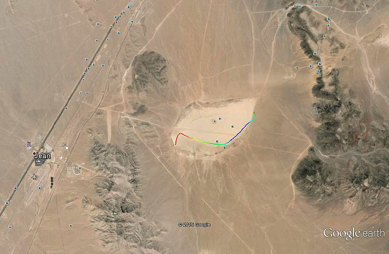

Figure 1: Google Earth overview of Jean Dry Lakebed location and glider track. Glider track color scaled for altitude - red surface levels and blue maximum altitudes.

Figure 2: Annotated flight instrument data plot of Time vs Altitude, Vertical Speed and Ground Speed along with GPS ground track of flight.

Figure 3: Annotated Google Earth plot of glider track and estimated tow vehicle track.

Figure 4: Google Earth side view of glider descent path looking NW.
