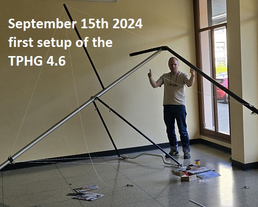

Postby Semper Fidelis » Sun Sep 15, 2024 12:09 pm
NO COMMENT...
Next, making the sail and steel cables.
Without sail nor cables, 17kg :thumbup:
More to come :salute:
Semper Fidelis
Posts: 115

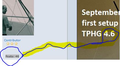

Postby JoeF » Sun Sep 15, 2024 4:19 pm
Semper Fidelis,
Congratulations!
Special coincident: your 46th post shows frame of your 4.6 TPHG ...
--No spreader
--No bowsprit
--Downtube extension is at upper end using coupler.
P.S. poem was A.I. created by an A.I. Chabot that had memory of much of my TPHG mulling.

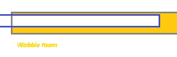

Postby JoeF » Tue Sep 17, 2024 1:00 pm
Wobble, wobble, wobble? Two tubes joining via several methods will present the challenge of wobble. How to mitigate wobbling> Let's in this note confine the note to joins of tubes intended to be parted for tote after each flight session. Further, let's restrict this note to the cases where seamless tubing is used. Further, let's attend only to cases where the tubes are to be part of tote nest where several tubes fit inside each other without being interrupted by tube interiors being stuffed with non-tube items except the most interior tube in a nest. Concentric nesting is assumed in this note. And finally assume that the two tubes definitely have a significant gap between the ID of the larger tube and the OD of the tube to be joined via overlap of some length with respect to each other. Then we have a gap that brings on wobble, if not mitigated by some means. Explore those mitigating means: bushings of various sorts, split bushing. wedges, Joe Cups, Elastic Joe Cups, Variable-wall Joe Cups, O-rings, washers, inflatable bushings. segments of tubular Teflon, segments of tubular fabric, etc. We want to be able to separate the two tubes at flight-session ending as the TPHG is packed for transport.

An advanced Joe Cup will do all the following:
1. limit insertion of the smaller tube into the larger tube,
2. protect the larger tube's end from hoop expansion,
3. fill the gap between the smaller tube's OD and the larger tube's ID,
4. provide opportunity for adjusting the insertion depth of the smaller tube,
5. be easy to assemble being fully apart from the tubes during TPHG tote,
6. be easy to disassemble after the flight session,
7. be well labeled for its position on the TPGH along with naming the two tubes involved,
8. be low mass,
9. be low tote volume, and
10. be easy to DIY make.
**Response:**
Development Note for an Advanced Joe Cup: Fabrication of a Precision Collar
This note outlines a DIY approach for creating a precision collar as part of the advanced Joe Cup system. The collar surrounds the end of the larger tube (mother tube) while the rest of the Joe Cup limits the insertion of the smaller tube (child tube).
Collar Roles:
1. Protects the hoop of the mother tube: The collar reinforces the open end to prevent hoop expansion during axial compression in flight.
2. Prevents over-insertion: The collar acts as a stopper, ensuring the smaller tube does not slide too far into the larger tube.
3. Provides additional structural support: The collar creates a more robust connection at the rigging anchor.
DIY Fabrication Method:
- Wrap Dyneema Thread: Over the end of the mother tube or a similarly-sized mandrel, wrap epoxy-wetted Dyneema thread in layers.
- Build the Collar: Tie knots at intervals to strengthen the wrap and form a durable shell segment around the tube.
- Inner Surface Treatment: Apply dry lubricant to the inside for easy removal.
- Sew the Joe Cup Body to the Collar: While the epoxy is still wet, sew the flexible webbing or straps to the outer surface of the collar to integrate both components.
- Cure the Material: Allow the collar to cure on the mandrel to maintain precision.
