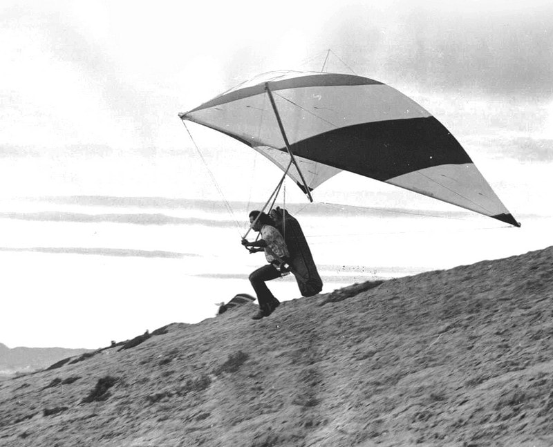

============================== Eddie Paul carried a TPHG while flying a TPHG Wikipedia article on Eddie Paul: https://en.wikipedia.org/wiki/Eddie_Paul
[cable-leading edge design is to be avoided, such is the HG community-wide prevalent opinion as reverse cambering by gust or AoA may occur]
Ode to Eddie Paul:https://www.hotrodhotline.com/ode-eddie-paul
TPHG backpacked while flying TPHG
CLICK photo to go to the full article. RIP, Eddie.
