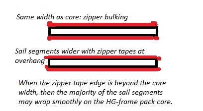

Zippering seems again attractive after discussing these zipper-less optional adventures! If only zippers did not bulk when rolled on a core for compact tote time!
ChatGPT wrote:Reconsidering Zipper Options for TPHG Wing Covering
After exploring various zipper-less options for the wing covering, the concept of using zippers is once again becoming attractive. Here’s a look at the potential benefits and drawbacks:
1. Benefits of Zippers:
- Secure Closure: Zippers provide a reliable way to keep the sail segments securely closed, minimizing air leaks during flight.
- Ease of Assembly and Disassembly: Zippers allow for quick and efficient assembly and disassembly of the glider, making it easy to pack and transport.
- Tension Maintenance: When zipped, the tension in the fabric can help maintain the integrity of the wing shape during flight.
2. Drawbacks of Zippers:
- Bulkiness: One of the main concerns is that zippers can add bulk, especially when rolled around a core for compact storage. This could impact the overall packing dimensions of the TPHG.
- Weight Considerations: Depending on the materials used for the zippers, there could be added weight, which is a critical factor in glider design.
3. Potential Solutions:
- Slimmer Zipper Designs: Consider exploring zippers designed specifically for lightweight applications. Some zippers are made with thinner materials that could reduce bulk.
- Alternative Zipper Styles: Look into options like coil zippers, which may offer a more flexible solution that could roll up more compactly than traditional zippers.
- Placement Strategy: Strategically placing zippers only where necessary could help limit bulk while still providing the benefits of a secure closure.
4. Conclusion
While the exploration of zipper-less options has been valuable, zippers still present an attractive solution for maintaining the integrity and functionality of the wing covering. Balancing the benefits of zippers against their potential bulk and weight will be crucial in making a final decision for the TPHG design.
If you have any further thoughts or want to discuss this option more, feel free to share!

Efficient Packing for Hang Glider Sail Segments with Side Zippers
A key challenge in packing a tiny hang glider with sail segments that feature side-running zippers is managing the bulk of the zippers to achieve a compact, wrinkle-free roll. Here's an effective solution:
When wrapping the sail around the toted core frame, ensure that the zipper tape runs beyond the edges of the core at both ends. By positioning the zipper's bulk outside the core's boundary, the sail can roll smoothly around the frame without the zipper adding bulk or creating wrinkles along the core's surface. This method keeps the zipper free from compressing against the sail fabric, allowing for a cleaner wrap and a much lower pack volume.
This approach ensures that the sail wraps tightly and efficiently around the frame while keeping the zipper edges suspended in free space beyond the core's edges. The result? Minimal wrinkles and a more compact, travel-friendly pack.
For example, if the packed frame forms a core of three tubes (telescopic nested frame tubes inside those three tubes) and the width is 48 inches, then aim to have sail segment runs be 50 inches permitting 1 inch overhang where the zipper halves bulk at the edges of the roll. The main body of the sail segments then may be snugly smoothly wrapped on the frame core.
