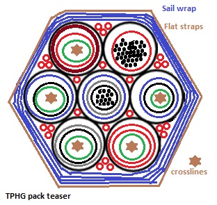

Someone might choose a "Seven-Nests Hex Pack" and use the cusp spaces for holding some rib parts. The hexagonal global resultant pack strapped is quite stable; kited end plates could stop nested concentric tubes from slipping out during transport. The seven nests may provide a more economic selection of tube ODs/IDs for sections that will join often with Joe Cups.

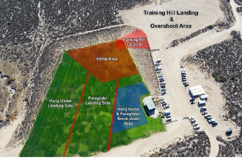

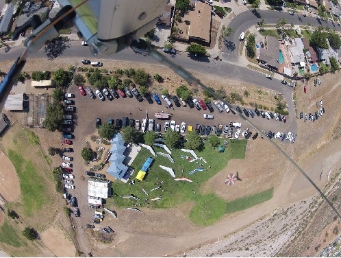

Florian will show and tell about his TPHG 4.6 on Saturday, November 16, 2024, someplace at or near Sylmar Flight Park:
Florian's TPHG will be shown Sunday, November 17, 2024, someplace at or near:
And on Monday, November 18, 2024, at Dockweiler Hang Gliding Park:

Postby JoeF » Tue Nov 12, 2024 11:17 am
:arrow: :arrow: I bet it would be an effective learning process to criticize all the errors, confusing suggestions, misapplications, and insufficiencies findable in the above AIs responses. :idea: :!:
A striking first confusing deal regards the seven parent tubes.
In pack it was suggested that the hang glider could have a multitude of element tubes that would find a position in one of seven parent tubes. When a parent tube has tubes nested concentrically inside the parent tube, such forms one nest for packing. The nested tubes in one parent could be quite distinct in specifications from the tubes in one of the other parent tubes. Indeed, the seven larger parent tubes need not match in OD or ID; each parent tube could be distinct in specifications from the other visible parent tubes. "visible" because in pack one sees in large the parent tubes; one does not see in pack but the ends of interiorly nested tubes. And nested interior tubes need not be 4 ft long; indeed, e.g., there could be two tubes of identical OD that are each 2 ft long and stack to become an interior stack reaching net 4 ft.: 2 ft + 2 ft = 4ft. There could be a 3 ft tube nested, for example, etc.
Postby JoeF » Tue Nov 12, 2024 12:59 pm
