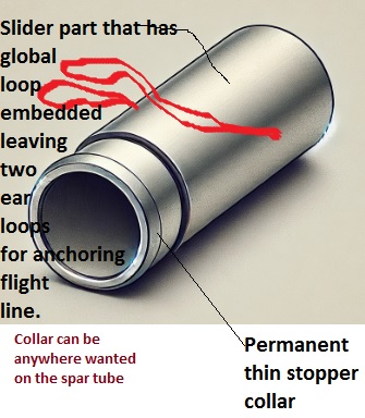

Have a spanwise spar assembly for left and right wing; have on the left two or more coupled spar tubes.
Challenge: On non-joint portion of a spar segment place on-and-off an "anchor" of low mass that can resist inboard pulling from a rigging flying line that starts at that anchor and goes to the two lower ends of the two queenposts and back up to a similar anchor on the right wing's spar. Avoid holes in the spanwise spar tubes. Avoid thickness of the anchor that would prevent tiny-packing telescopic nesting of the spar tube. The device might come off and on or might stay permanently fixed to the spar tube; if the device is permanently fixed to the spar tube, then the design should not stop easy telescopic nesting. Else, if such perma-on solution is not had, then the device should be able to be placed and offed easily for the tiny packing effort. Search for solutions. Anyone?
Three general classes of solutions are seen, so far: (there may be more classes)
1. Device is fully removed from the spar during packing.
2. Device is fully permanently on spar during packing and flight.
3. Solution as two devices, one packs separate from tubes, and one device stays permanently on the spar tube.
So far, I am favoring the class 3: Complex slider eared with two loops that come from a global loop of Dyneema cord which has main body wrapped around helically and molded/embedded in a polymer (polyurethane or epoxy or other). The slider is generally a cylindrical short tube, say 1" long that just snuggly slides on the spar tube. Then the second part of this solution is a thin stopper collar that is permanently well bonded to the body of the spar tube. The thinness is not more than the gap width that occurs when the spar tube nests approximately telescopically during tote of the packed tubes. Thus, the stopper collar retains the ability to nest the spar tube into other frame tubes. Flight lines pulling inboard that are anchored on the two loops of the slider part pull the slider part against one end of the permanently bonded thin collar. The innards of the slider part sees the central portion of the Dyneema global loop helically wrapped twice before polymer embedding; such assures that that flight forces tend to grab the spar tube more firmly without means of releasing the helical wrap that then wraps the spar.
