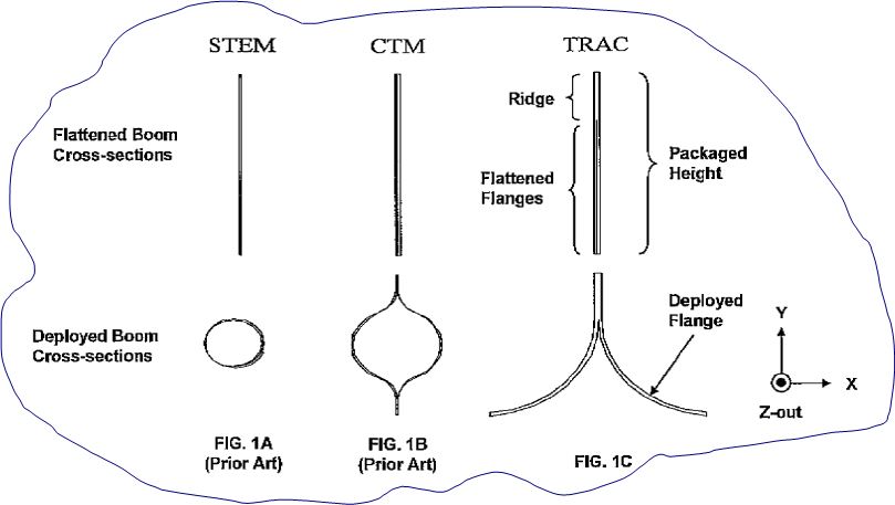

Different from the rollable boom mentioned in prior post are the slit-tube rollable booms. Recall coiled measuring tapes that has been mentioned before in our forum a US Hawks.
ROCCOR is pioneering the use of composite slit-tubes as rollable booms for stand-alone deployable booms or as an underlying structural element for a wide array of deployable structure systems.
tags: elastic slit-tube booms, rollable boom, rollable spar, coilable spar, roll-able trusses, rollable trusses, deployable booms,
Roll-out composite truss
Triangular rollable and collapsible boom
US 7895795 B1 Thomas W. Murphey, Jeremy Banik

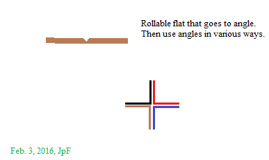

Coming to me, probably obvious to those skilled in the attending arts, is a spark:
Rollable angle. Then set two angles arm back to arm back to stabilize each other. Consider sandwiching web by two pairs of such that is also rollable. Consider setting such interior of inflated Trinity One Spar.
Also, consider four angles giving cross for setting in interior of inflated spar; then use four bladders.
The rollable angle is flat and rollable. But its form in flat is with a notch of about 90 degrees while retaining material for hinging; deploy to manual or elastic angle.

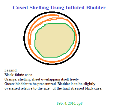

Postby JoeF » Thu Feb 04, 2016 12:52 pm
Shelling from using furled flats unfurled and case while stressing by use of inflated bladder
Consider using two furled flats curled within case; have positively inflated bladder to press the curled sheet under case constraint.
Example: have a spar case of fabric that constrains spar diameter(D) to be 12 in. C=piD has (3.14)(12 in)= 37.7 in approx. So, our shelling would need to be at least 37.7 in; but because one will not want a sharp ending of shelling inside the case, going for overlap prevents such. So, say go for 60 in in the flat that will curl to be inside the fabric case; the overlap of shelling will then be about (60-38)= 22 in approx. The overlap perhaps strong shelling effects for the resulting spar. The 60 in would be the furling length. Say the spar is 33 ft long; say, have 60 in wide sheet that is 33 ft long. Furl the 5-ft wide by 33 ft sheet using the furling axis be the 5 ft.
Example at site: Unfurl the 5-ft roll of shelling sheet to be a flat of 5 ft x 33 ft. Have assisting belts. Begin to curl the big sheet using assistive belts; get the curled part to be just less than 12 in diameter. Dress the curled part with the fabric case by inverted peeling method; upon dressing the first part of the curled shelling, place another assistive belt on the outside of the case to pinch the shelling to be about 11 in in diameter; then dress the curled part more up to an assitive belt; place another exterior assistive belt; then such action just made allows releasing and removing the first assistive belt; then keep dressing the curled part in similar fashion. When the curled part is fully dressed, then there will be no interior assistive belting and only exterior assistive belting; then remove the exterior assistive belting and let the interior curled shelling expand to stress the enclosing fabric case to the 12 in diameter. Then insert an inflatable bladder inside the interior of the spar. Care for ending the spar is not presented here; assume the ends are resolved. Inflate the bladder; the bladder will press the shelling and stress the case; the case will constrain the diameter of the spar. Excessive pressure would burst the case; so, have case that will stay working under the stress that will occur; limit pressures in the bladder to match design wishes. Result: a spar that features shelling from the case and from the shelling sheet. The choice of sheet may vary according to needs. Here, there is a looking at sheets that may be handily furled at the 5 ft furling dimension.
What sheets are COTS (commercial off the shelf) that may solve some wishes? Reports of your experiments are invited. I will be reporting my experiments with various shelling sheets. I have not yet made but small models of this method. Suggestive approximate similarity cases: feet in socks, arms in sweater sleeves, packing posters into poster shipping tubes, bands around barrels, bands around stowed rolled carpets, bands around rolled maps, roll up a piece of notebook paper and place it inside of a long sock and then insert a latex toy balloon and blow up the balloon to stress the sock, ...
How does this shelling method compare to just using an inflated airtight bladder of sturdy formation, say light is used in making Frank Colver's packraft? Say, have a seamed bladder made from special fabric treated with special materials. The shelling method could use a case of netting or other COTS fabric; the case need not be watertight or airtight; the case can be very porous. And the shelling sheet need not be without holes; the shelling sheet could be with thousands of holes, so long as the bladder used does not get injured by pressing against the holes; smooth shelling material will let the bladder press against a smooth surface. But the shelling that overlaps itself does not need to be airtight; only the interior bladder needs to be airtight. So, the shelling method may use many different COTS materials; then have a bladder that works. Rafting and boat inflatables are facing water challenges, abrasion challenges, etc.; the boat have to keep water out and air in; differently, the hang glider or wing spar usually only has to face keeping air in the bladder; let abrasion be taken by the case and shelling. For the wing use, one usually is not concerning with letting water in, unless one aims to have a water-landing hang glider or wing.
Bladders: study power-kite bladders and also raft and boat bladders.

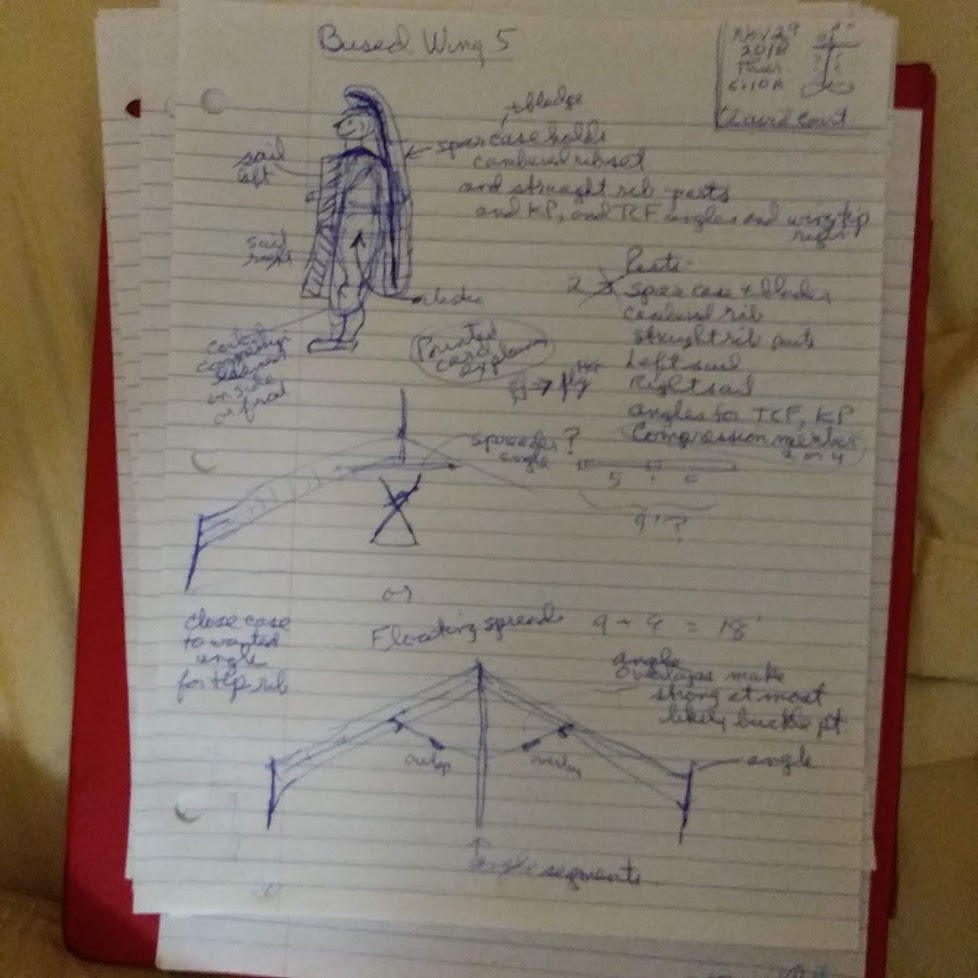

Postby JoeF » Thu Nov 29, 2018 11:34 am
The sail is not drawn in the note.
The waking note mainly stemmed from a subconscious waking mare concerning possibly having the camber of rib parts flow from one's back over the top of the head; the thought upon waking was that maybe even a sombrero could be worn to top the cambered part. Sombrero: also not depicted.
The version in the waking note of today features "inflated-case-bladder" spars (left and right); such deflate to flat and packable items sketched as being made into a bag to back-pack sticks (rib parts, TCF parts, KP(s), spreader assembly parts, tip-sticks). Spreaders are noted as left assembly and right assembly; each assembly might be of two overlapping angle cross section sticks; the overlap of two parts gives extra anti-buckling mass and section at center of the compression spreader where buckling is most likely to occur; the angle choice permits nesting during tote; similar for the other side's spreader assembly. TCF and kingpost(s) may be angle sticks. Note depiction has sail-mains packed in two packs stacked in front of carrier's body. Maybe wear harness and hang front packs in balance with backpack. The splinted airbeam spar tech is served with a splinting compression member that might be coilable (say 16' long coiled to a radius that would fit the total tote system; aggregate coilable might be explored (say two or three smaller-diameter rods.
Note: In-bus tote manner could well be different from trek off-bus manner. E.g. In-bus manner has special challenges; initial boarding has its challenges; that point is where bus driver PIC permits or rejects one-with-wing to board.
After getting off the bus, there may be a considerable trek with Wing-5vers.? During such trek a morphing of pack could occur that has wheels do the load carrying, e.g.
An hour after waking today: Maybe ribs could use splinted airbeam tech; use small diameter compression splints; such might result in not having to have anything above neck in tote.
Etc. Such notes are amount hundreds of notes during this designing stage.

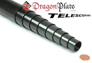

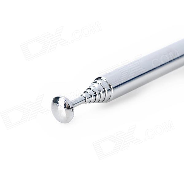

Why not telescoping leading edge and keel? Seems like you don't need the same diameter leading edge towards the tips.
