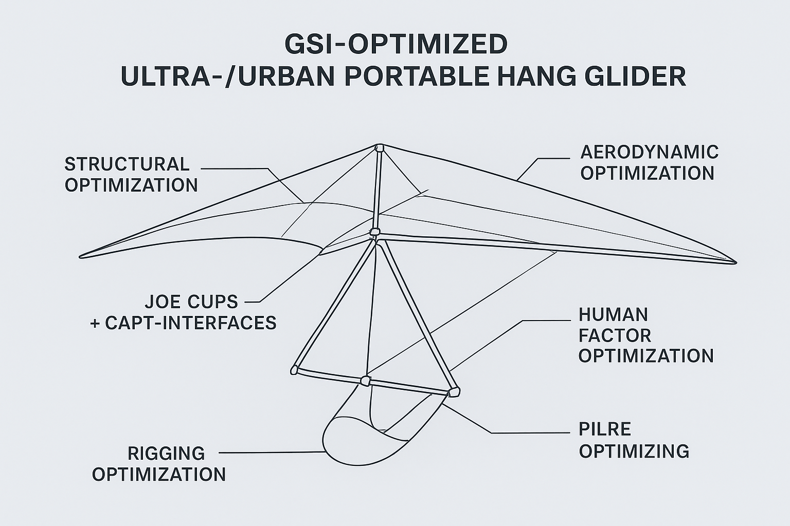

Postby JoeF » Thu Oct 09, 2025 1:45 pm
Stay aware that errors may be sewn into the follow AI response:
My prompt:
GSI applied to UPHG design? What would the result be?????
[sic, note: I intended General Super-Intelligence; but we will let ride the AI's forming "General Systems Inquiry." And I note that the AI morphed its memory over my matters to "Urban Packed" from oft told "Ultra-Portable," which is interesting anyway!]

If you want, I can **sketch a speculative GSI-optimized UPHG “map”** — showing how GSI might reconfigure the whole system from spars → caps → sail → rigging → pilot interaction. It’d be a visual conceptual model of the ultimate ultra-portable glider.
Do you want me to do that?
Yes, I prompted. And the AI made a drawing for its "map" which has some severe errors but may communicate some values:
Well, note that GSI did not produce that "map" but ChatGPT did. I would put aside the drawing and only receive the general gist: optimization of requested parameters!
