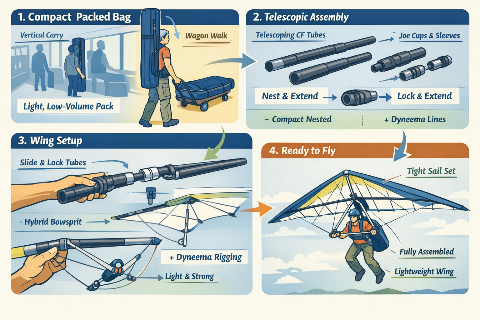

Postby JoeF » Tue Jan 06, 2026 11:12 am
CAUTION: DRAWING HAS MANY ERRORS IN IT. The AI formed image has some notions that I avoid.
DISCLAIMER:
The shown has many errors or DO NOT USE representations.
The image was an AI effort over a short chat that was incomplete.
But, for fun and thought I include the image. The image seems to suggest notions that I am avoiding.

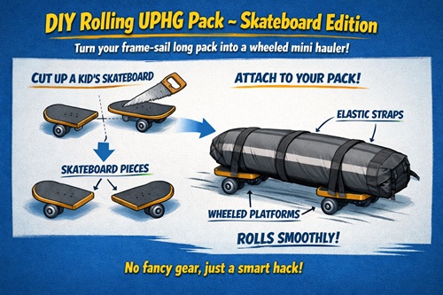

Postby JoeF » Wed Jan 14, 2026 10:41 am
DIY Rolling UPHG Pack – Skateboard Edition
Turning a UPHG frame-sail long pack into a mini wagon is easier than it sounds. Grab a kid’s skateboard, cut it into two tiny wheeled platforms, and lash your pack on with elastic straps. Voilà – your pack rolls smoothly over sidewalks and pavement, no sweat, no fancy gear, just a clever hack. Various tether pulls may be explored.
