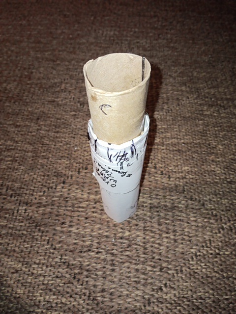

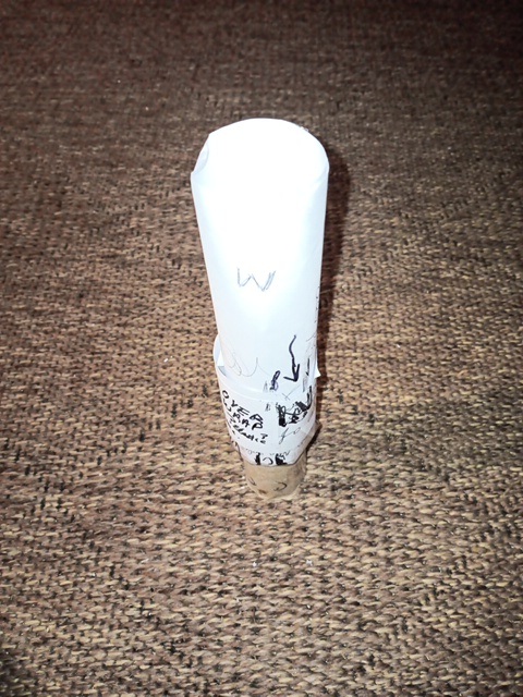

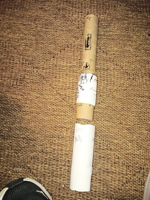

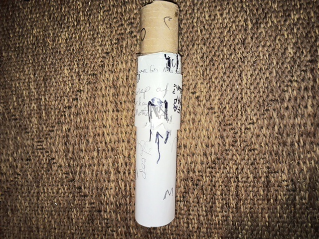

Postby JoeF » Thu Feb 19, 2026 8:14 pm
Paper mockup of a version of the above noted specialized Joe-Cup system, perhaps named "islands" until a better name arrives:
