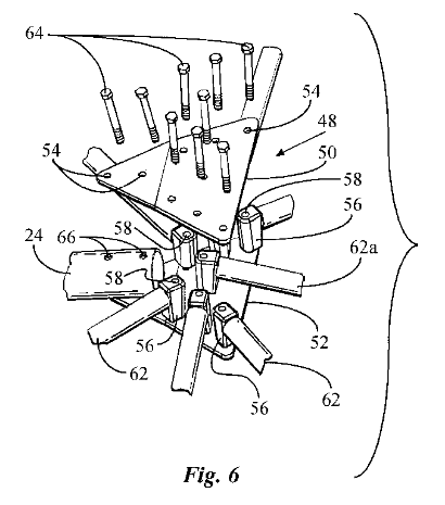

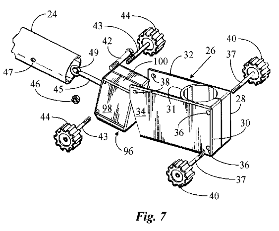

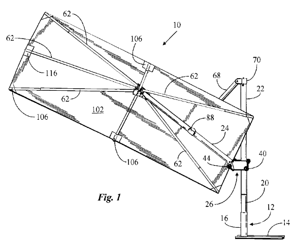

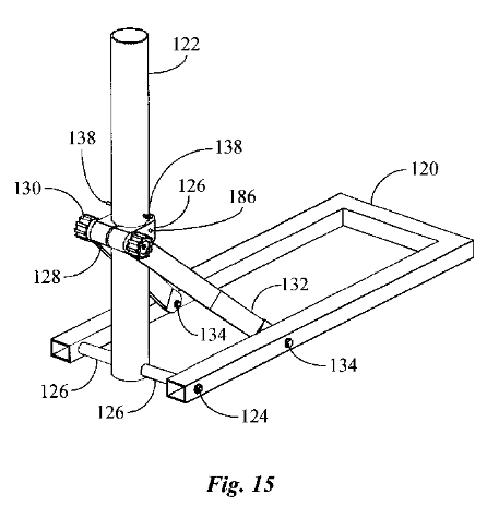

Here's are some drawings from a patent by a well known hang glider pilot:
The patent is not for a hang glider, but some of the skills used in this invention might be useful for designing and building Wing5.
