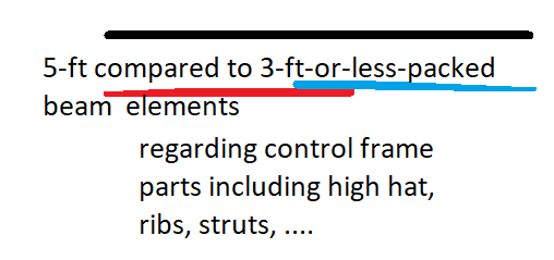

Wing5 designing progress:
Beams for the High Hat (HH) and control-frame downbeams will probably each be made of two parts joined; aim is to provide:
1. Center-beam anti-buckle enhancement
2. Taper from beam center to beam ends
3. Shorter-than-5-ft-pack potential. Going toward 3-ft pack instead of 5-ft .pack
4. Considering beams as C channel or angle format for packing using part nesting
5. Aiming for some "wearing" of parts; the shorter lengths may allow "wearing" of some beam segments.

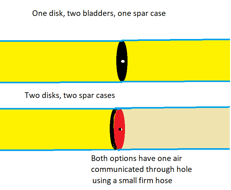

Miscellaneous idea:
Two bladders that communicate via a firm hose? A ring at spar center placed inside the spar case could be a disk with a small hole; run a small communicating hose through the small hole that joins a left bladder to a right bladder to obtain equal pressure in both left wing and right wing bladders. The rigid disk might stabilize the spatial position of the crossing point of the Dyneema straps that wrap the outside of the spar case from ends of the compression elements. The rigid holed disk would become part of the keel system. The disk or disks might provide a good foundation for the X fitting.
Unbaked: two disks at center closing a sided spar case; bolt disks together; have air-communicate hole and hose in both disks. Would having sided spar cases and sided bladders bring some benefits in flight, in packing?

1. Tightness of bond of compression element to the spar is going to be paramount. A high shearing stress occurs between the compress element and the skin of the air beam during flight loading.
2. A central rigid disk will give advantages. Lower air pressure, if the rigid disk at keel is one advantage. Less deformation of spar when loaded will result. Having a central rigid disk at the keel in the air beam may mean having a left and a right bladder that communicate air and its pressure via a short hard hose.

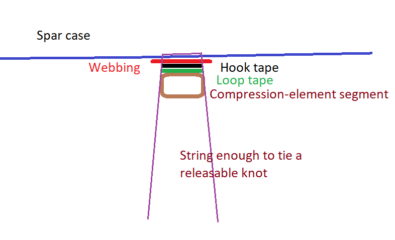

Holdfast CE segments to spar case:
Layers:
Inverted U tie string hand sewn to the below spar case-webbing-hook tape; leave enough length of the string for making the securing knot; knots should be easily unknotted for packing operation. Have such string item at the tips of the segments and two stations interior of the CE segments; that make four such strings per CEL segment. With nine or ten CEL segments that will be 36 or 40 strings to be given a knot tying. The strings are permanently joined to the spar case and webbing.
Spar case
Webbing spanwise sewn to spar case
Hook tape sewn to webbing
Loop bonded to top of CE segments
CE segments
Tie shoe-tie tight knot using the ends of the inverted U tie string.
Packing: release knots; invert spar case; peel off spar-case-hook tape. The CE segments with loop tape segments then will be free to pack.
