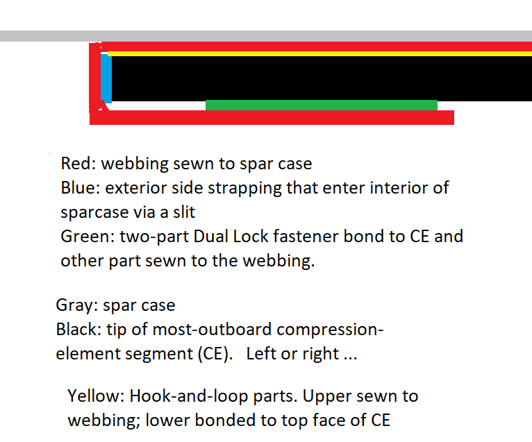

Assembly focus for this comment regards the matters at the outboard tip of the most outboard compression element.[/b]
Have the spanwise webbing that is sewn well to the spar case be sewn also to the hook tape be with extra length of say 5 inches. On that extra length of webbing sew Dual Lock for say 4 inches of length; match the Dual Lock by bonding say 5 inches length of Dual Lock on the interior face of the CE segment. Wrap the exterior loading tension strap around the end of the CE: then wrap the webbing excess atop the exterior loading tension strap and seat the Dual Lock.

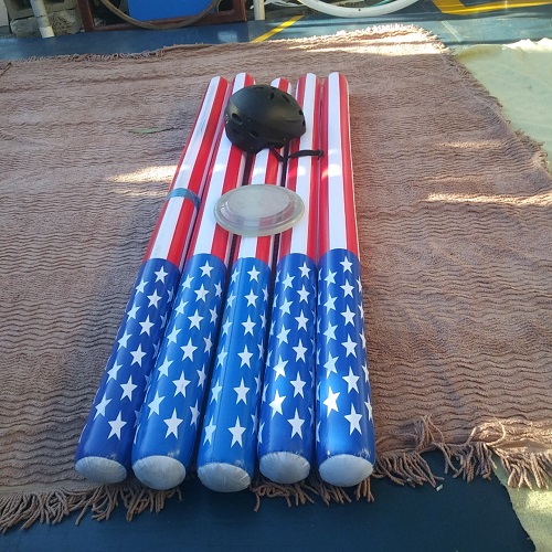

Five bladders for model work toward Wing5 matters:
Helmet and toy toss disk shown. No spar cases or compression members for models yet. Soon.

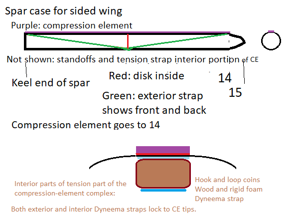

Notes toward iteration one of Wing5:
Looks like the compression members will go on the exterior of the spar cases.
And the compression member assembly will sandwich the spar case with an interior stand-off complex finished by an interior strap of tensioned Dyneema strap. Dual Lock will probably be used exteriorly and coin hook and loop on the interior. The strap will grab the ends of the compression element of spars. There will be a spar for left wing and spar for right wing; abandoning single-spar approach for iteration one.
Approximate 13 ft of compression element per spar; the compression element will not go to the wing tip; I will see how such goes.
The stand-off complex will mix wood and rigid foam parts of about 3-ft lengths; bond the short wood standoffs with bars of rigid foam. The Dyneema strap will ride on the interior face of such complex sticks. Strap will not be bonded to the stand-off sticks.
Postby JoeF » Wed Aug 04, 2021 10:38 am

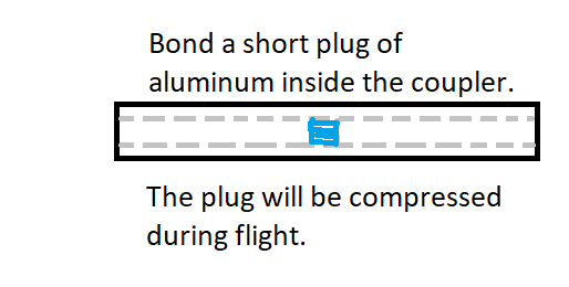

Iteration one of Wing5 looks like it will feature the following compression-element coupler:
Rectangular tubing with an interior stop bonded. Adjacent compression element will press against the interior stop of the coupler. The left wing spar will feature three (3) couplers for coupling four (4) compression elements. Dual Lock will not be on the coupler's face; but the exposed face that has no coupler material that faces the spar case will have Dual Lock. The spar case will have matching Dual Lock in matching spaces.
As build comes closer, it appears that 3.5 ft pack will arrive rather than the 3 ft. 4x3.5=14 ft; a foot without compression element may sustain at the wing tips where pinch closure will be employed to give foundation for tip rib. Keel end of the two spars will have spar case closed with end disk of fabric.
