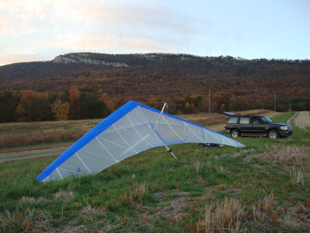

TOMMY in NC > WW 195 Attack Falcon pilot
Flying HG's 42 years
Mylar sails are sweet
Sauratown 11-6-13 012.JPG (137.34 KiB) Viewed 6709 times

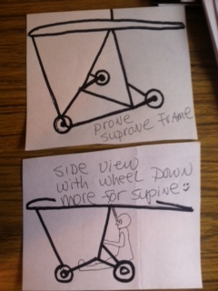

Postby soar8hours » Mon Dec 09, 2013 12:05 pm
We teach HG's students to fly upright on the training hills.
Then they are later taught to transition to the semi-prone or prone positions.
#1. I always wondered why they don't give the student a choice of seated or prone?
It's the way we drive our cars, fly our planes and ride our motorcycles basically.
I think a light weight set of tubes going forward and a tube from the front to the nose
would prevent the nose over sudden stop / whack? Then a bar of each side of the
downtubes going reaward for the main wheels? This is for prone / suprone pilots.
You could angle the rear wheels down at an angle for supine flyers.
No need for a cart for towing either. Northern tools has great 16 & 20 inch wheels too!
What is a little extra weight and alot more safety really worth?
Just doddle'n... I am not artist.
I always liked riding my snow sled better sitting up :thumbup:

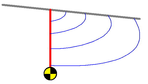

Postby Bob Kuczewski » Mon Dec 09, 2013 12:07 pm
JoeF wrote:ARP and JpF and inviting others to advance limit lines tech
Hi Joe,
Please feel free to include this diagram in your site:
There are some problems with this idea ... in particular, since the mass of the pilot is generally much greater than the mass of the wing, the wing will not likely stay fixed as shown in the diagram (although aerodynamic forces help slow the wing's rotation much more than they slow pilot's rotation). But it might be another puzzle piece to trigger a better idea in someone else's brain.

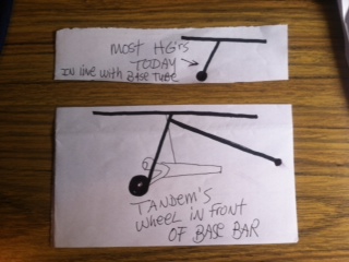

Postby soar8hours » Mon Dec 09, 2013 12:51 pm
Todays wheels are slightly out front or inline with the base tube.
This forces the tail down & you drag the harness boot unless there is a keel tailwheel.
Still does not address the nose over whack problems.

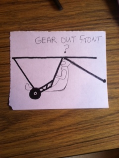

Postby soar8hours » Mon Dec 09, 2013 12:55 pm
How about a forward gear with an axle across and a tube to the nose?
Seated pilots put feet on bar :)

Postby Bob Kuczewski » Mon Dec 09, 2013 7:55 pm
I I like this one Tommy:
soar8hours wrote:Image
But then I learned on tricycle gear aircraft ... as opposed to tail-draggers!!      ;)
Actually Joe, it might be fun to try something like this at Dockweiler some time (with the other Joe's permission of course).
The only problem I see with this design is that the aft gear brace will try to bend the downtubes. Since the downtubes are in compression, they're particularly vulnerable to being bent. There might be another way to brace them from the rear end of the keel or with a more rigid structure to the nose wheel which wouldn't put a transverse load on the down tubes.
Other than that, I'd like to give that one a try!!
