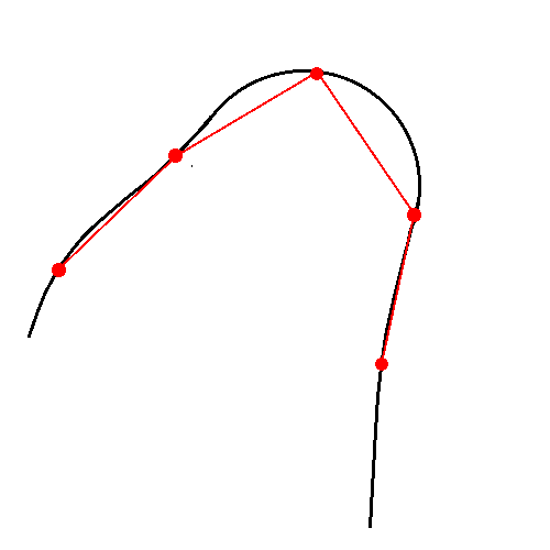

It just occurred to me that tight turns will show a slower ground track than airspeed since the two second interval setting will be straight line point to point whereas the glider is flying a faster arc.

billcummings wrote:It just occurred to me that tight turns will show a slower ground track than airspeed since the two second interval setting will be straight line point to point whereas the glider is flying a faster arc.
Like this?
I guess if you were flying a fast 180 degree turn and the 2-second samples were taken at the entry and exit points, it might show your ground distance as 2 times the radius, but the actual distance travelled would be pi times the radius. The difference between 2 and 3.14159... is pretty significant.
Of course, they may be sophisticated and use a curve fit (Bezier, for example) to come up with locations between samples which would be much more accurate.

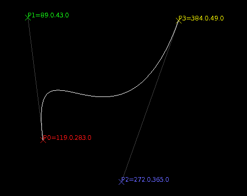

billcummings wrote:Yes Bob, Exactly what my minds eye was seeing. Also found this"
http://www.math.ucla.edu/~baker/java/hoefer/Bezier.htm
Also this:
http://www.math.ucla.edu/~baker/java/hoefer/Lagrange.htm
That's an amazing coincidence ... Here's my Bezier Curve program ... also written in Java:
I used that basic code years ago to develop a landing approach system for a simulator I was building at work.
