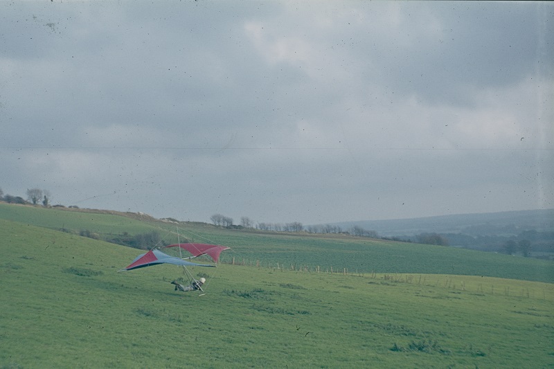

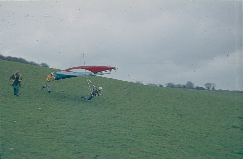

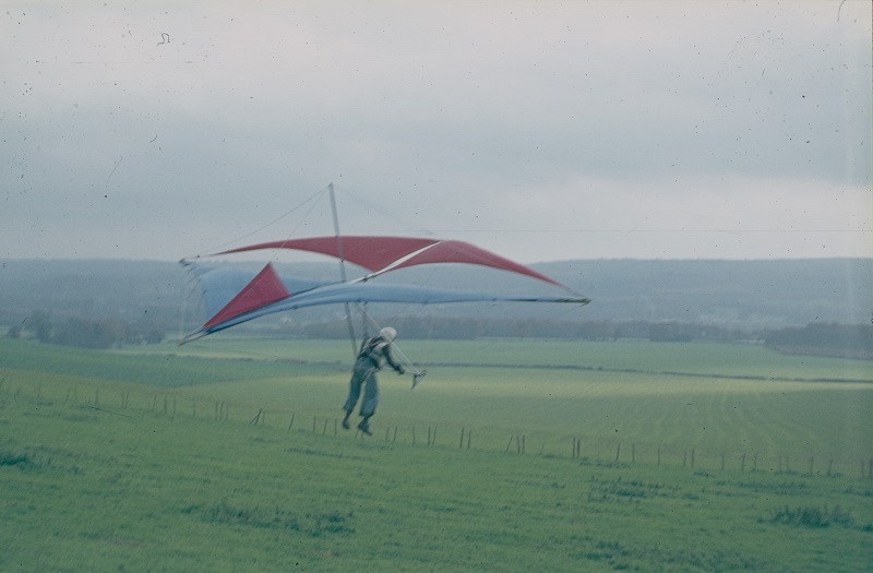

Mk3 showing a more conventional HG airframe. This picture of the MK1 being flown by a complete novice has got into a very high nose up attitude but the wing is still working. With a bit of a tail push he recovered and carried on flying.

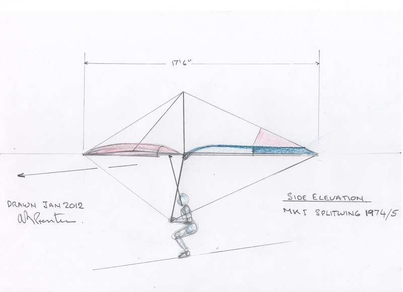

Postby ARP » Thu Mar 03, 2016 7:41 am
Side elevation:-
SW 003.jpg (88.45 KiB) Viewed 4953 times

ARP wrote:Mk3 showing a more conventional HG airframe. This picture of the MK1 being flown by a complete novice has got into a very high nose up attitude but the wing is still working. With a bit of a tail push he recovered and carried on flying.
That is very very impressive!!!
What was the wind speed that day?
Re: Vintage "WHITNEY" Hang Gliding Sales Brochure & 4 Photos
Postby ARP » Wed Mar 09, 2016 4:25 am
Hi Bob,
The picture is misleading if you think I am doing a Superman action in holding up an aircraft with one hand. The glider is still flying but the novice is not correcting the nose up attitude. My input is minimal but enough to correct the pitch up and get him going again.
It was 40 years ago but I guess the wind speed was around 10-12 mph as I would not have had a novice flying it if it were more. If a replica gets built you can see for yourself how slowly it can fly.

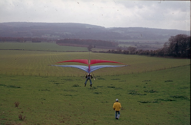

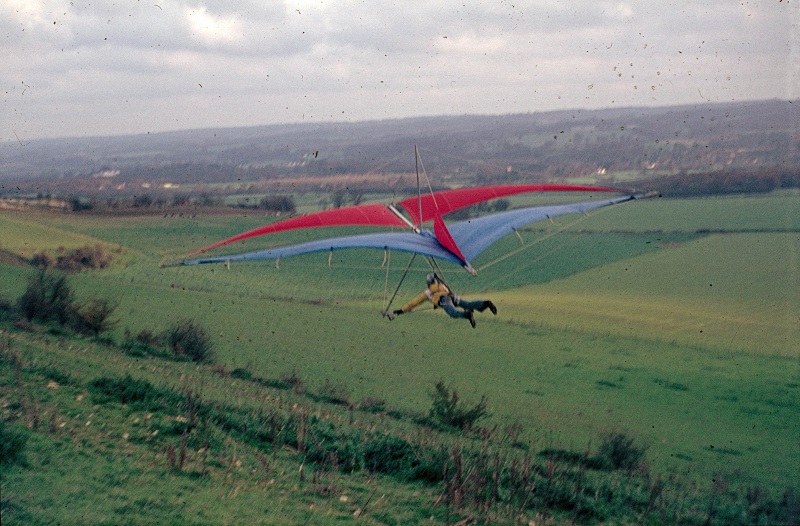

Soaring the slope on the same day:-

Postby ARP » Fri Mar 11, 2016 9:38 am

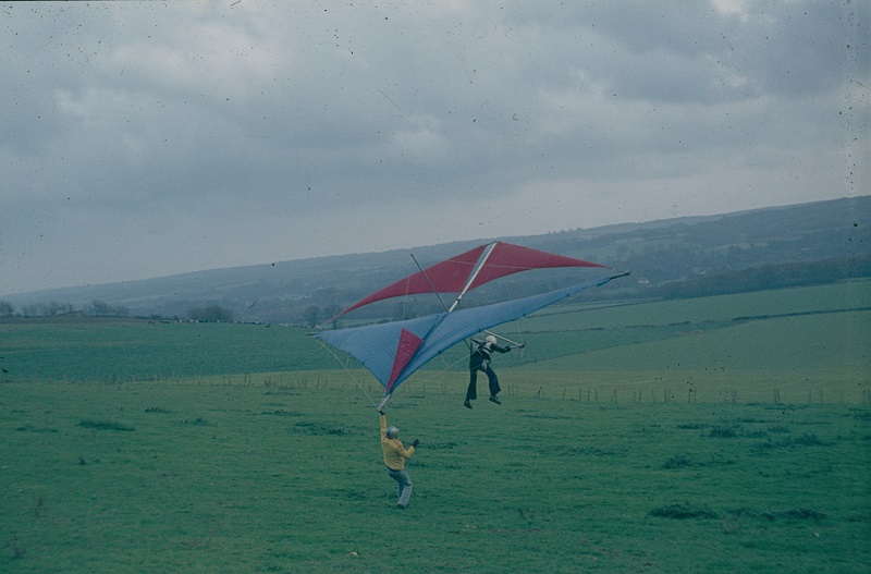

For your interest Sam another picture from the same day. The novice skimming close to the ground. The base bar skids enabled a belly landing if required:-

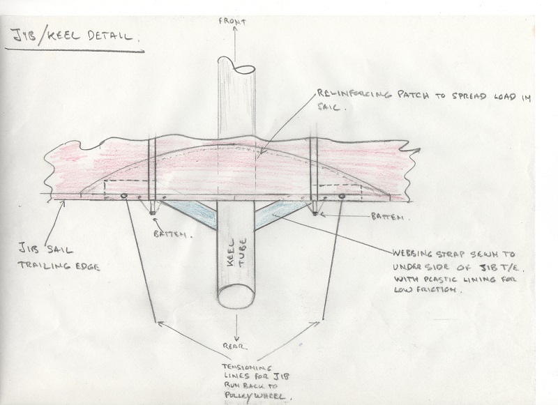

Hi Frank, There was some adverse yaw which delayed the roll a bit, as can be seen in this old film of it on youtube:- https://www.youtube.com/watch?v=BDUrX_o727Y . To compensate for this the design has been modified to provide more effective billow shift on both jib and main sails. The addition of battens will help keep the aerofoil in the correct shape as you can see the blow down of the mainsail leading edge occurring at times.
As for the weight, I think it was about 35-40lbs but easy enough to carry around. As with the Whitney it could be made to break down to a bus-able length but the joints would add a bit more weight.
It was not difficult to adjust the flight trajectory to land before or after the fence.
Modified jib sail fixing to provide billow shift
sw 001.jpg (119.88 KiB) Viewed 4805 times
