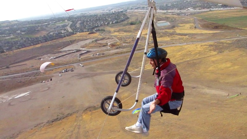

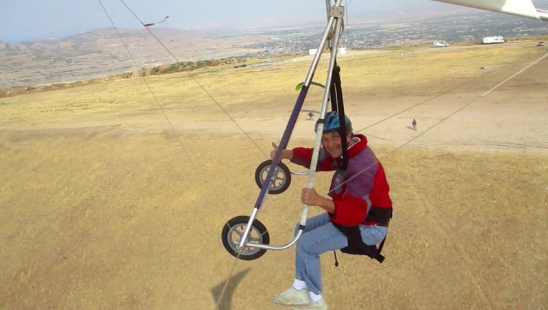

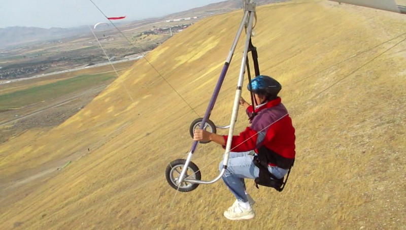

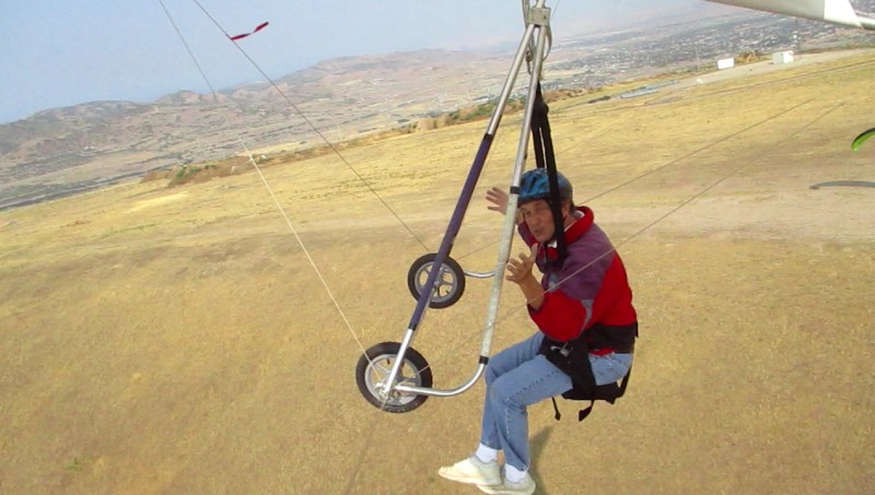

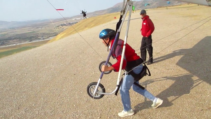

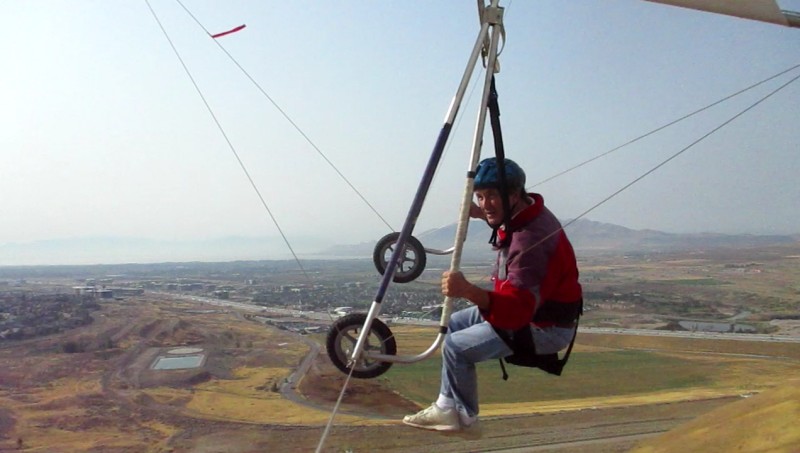

Wow!! Flying high in the Colver Swing Seat at Point of the Mountain!!
Thanks Frank!!!
