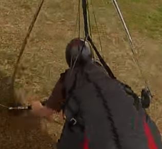

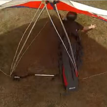

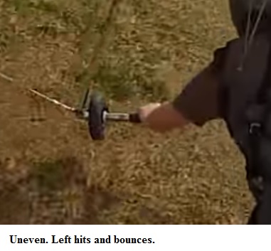

A TCF basebar with its corners form structure that may bring snagging, gouging, digging with abrupt possible disaster. Already the basebar is a form of skid, but a very poor skid without much spooning. Necks and deaths have occurred from the abrupt gouging of the basebar. One might hope that a landing might be done without any touching of the basebar. But during HO, H1, H2 there have been very many launching and landing touches of basebar to the groun; and for H3, H4 also! It is the one time that inadvertent gouge occurs that one finds out that maybe a good spoony skid would have saved injury. The big wheels at landing in sand do not do much good. The big skids of pontoons for water landing do some good!
Looking for some good wording for the conduct regarding wheels, skids, skis .... ????
Thanks for teaming on this.
Current change to the line:
Have adequate skids or wheels or skis or pontoons on airframe. Optional. Controversial. Comments are invited.
The shown pilot had several challenges; and finally at the landing the problems were more important; he was lucky past his errors; the wheels were not quite adequate for his final use of them; but the wheels at the angle of impact did a bit of good; raw corner of the basebar without the wheel would perhaps have done him in. Hang Gliding Crash Lookout Mountain, March 15, 2014
Go to near the end of the video.

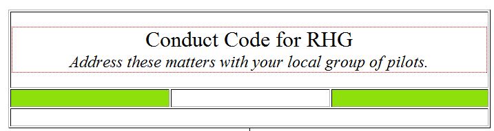

USHGS has taken the Conduct Code file off index lead front page.
The remnant file will keep the following terse statement:
In Q&A:
Conduct codes? Address such matters in your local RHG group.
