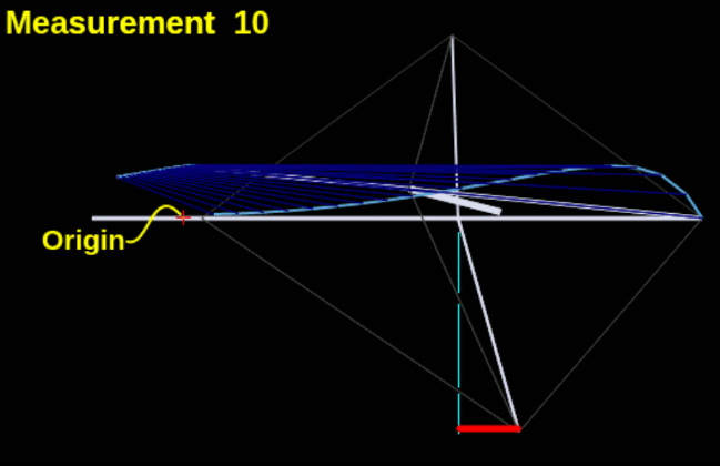

Here's the diagram to take the 18 measurements. It's animated, and it will show each measurement in red along with the number from the table below.
#Name Value                 Description
1Length of Leading Edge        Length of the leading edge from nose to tip
2Length of Keel        Length of the keel
3Keel Front y        Distance from the origin to the front tip of the keel
4Keel Rear y        Distance from the origin to the rear tip of the keel
5Wing Tip x        Distance from the origin to the right wing tip
6Wing Tip z        Vertical distance between the origin and right wing tip (this might be hard to measure, so just estimate it)
7Control Bar Height        Vertical distance from the base tube to the keel (perpendicular distance from the keel to the base tube)
8Control Bar Width        Width of the base tube from corner to corner
9Control Bar Location        Distance along the keel from the nose to the apex of the control frame
10Control Bar Rake        Horizontal distance along the keel from the apex of the control frame to the base tube (this may be hard to measure, so just estimate it)
11Cross Bar at Leading Edge        Distance along the leading edge from nose to cross bar junction where the cross bar meets the leading edge
12Cross Bar at Keel        Distance along the keel from the nose to the cross bar where it crosses the keel
13Cross Bar z from Keel        Vertical distance between the keel and the cross bar (typically 0 to a few inches)
14Kingpost at Keel        Distance along the keel from the nose to the kingpost (you can also measure from the rear of the keel and subtract from the keel length)
15Kingpost Height        Vertical distance (perpendicular to keel) from the keel to top of the kingpost
16Kingpost Rake        Horizontal distance (parallel to keel) between top and bottom of kingpost
17Trailing Edge        Distance along the keel from the nose to the trailing edge of the sail
18Rear Wire        Distance along the keel from the nose to the rear wire where it attaches to the keel
Also, since you called about measurement 10 (Control Bar Rake), I've posted that frame below. Measurement 10 is shown by the red line at the bottom. It is the distance (parallel to the keel) between the base tube and the apex (where the downtubes meet the keel). If you have a speedbar (curved base tube), then measure as if it were a straight base tube. The software doesn't model curved base tubes yet. Here's a picture showing Measurement 10 in red:
Note: I used the word "rake" as defined in Wiktionary:
    "A divergence from the horizontal or perpendicular; a slant, a slope."
With that usage, you might say "The base tube is raked forward about a foot from the apex point".
