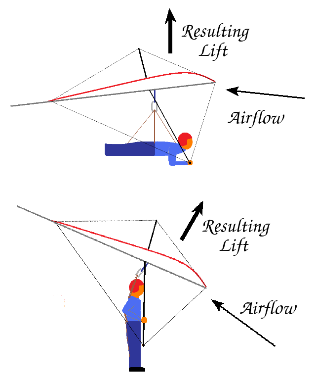

Al, there is a possible way that the glider can exert a force to pull you forward.
The airfoil shape of your wing (hang glider) creates a lower pressure area above your wing. It lifts up. If you are on a cliff and have the nose of your hang glider down then the lifting force will pull you foreword too. ( I call that ramp suck!) I don’t know the source or your quote but I totally disagree with that statement.
If your nose is down on a windy steep hill it will pull you forward. I don’t care how knowledgeable the person you quoted is that made the incorrect statement. He/she is incorrect!

Here's a sketch of what's happening with "ramp suck". The glider generates forces based on the relative wind that it feels. In normal flight (top diagram), the glider is designed to generate a force which opposes gravity (thereby holding you up).
When you're launching in most conditions (bottom diagram) the wind is coming up the ramp, so you need to keep the glider pointed down the ramp to keep it from being stalled (very bad on launch). By rotating the glider down into the same angle of attack (relative to the wind), the lift vector rotates with it. So pointing the glider down causes the lift vector to rotate forward which is actually pulling you forward. So it is very real!!
