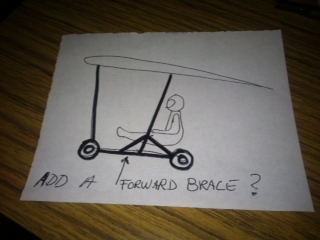

Well I think a forward diagonal brace would solve that minor problem?
Tommy
forward brace added.JPG (29.94 KiB) Viewed 6666 times

soar8hours wrote:Well I think a forward diagonal brace would solve that minor problem?
OK, I feel much better about it now.      ;)

BobK, on an alternate way to brace those afting wheels: fulcrum rocker arm at down-tube base and at the forward end of the rocker arm have a tension line to the keel.
